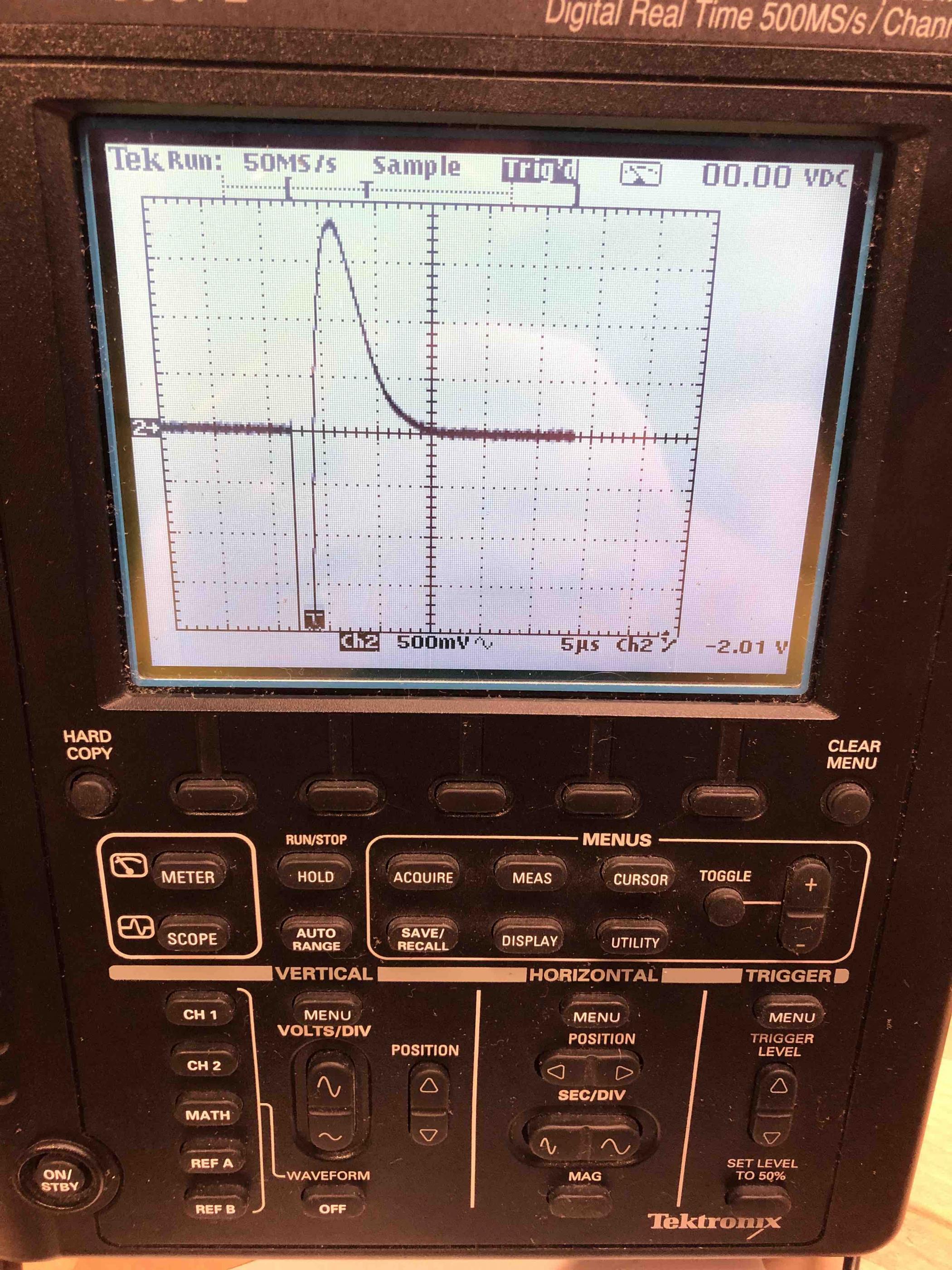

Here are my measurements with the Quasimodo SMD. I confirmed it was working correctly using a measured 2.98 mH inductor. Sorry for the images of the results, the scope is old and I couldn't get the capture software to work yet.
Antek AS-4225: 115V primary (shorted), dual 25V secondaries (1 secondary shorted, measured the other) - First image
Cx 10nF
Cs 150nF
Rs 11.8Ω
Triad VPM18-1390: 120V primary (shorted), dual 9V secondaries (1 secondary shorted, measured the other) - Second image
Cx 10nF
Cs 150nF
Rs 16Ω
Amveco 70064K: 115V primary (shorted), dual 18V secondaries (measured in series) - Third image
Cx 10nF
Cs 150nF
Rs 107.9Ω
