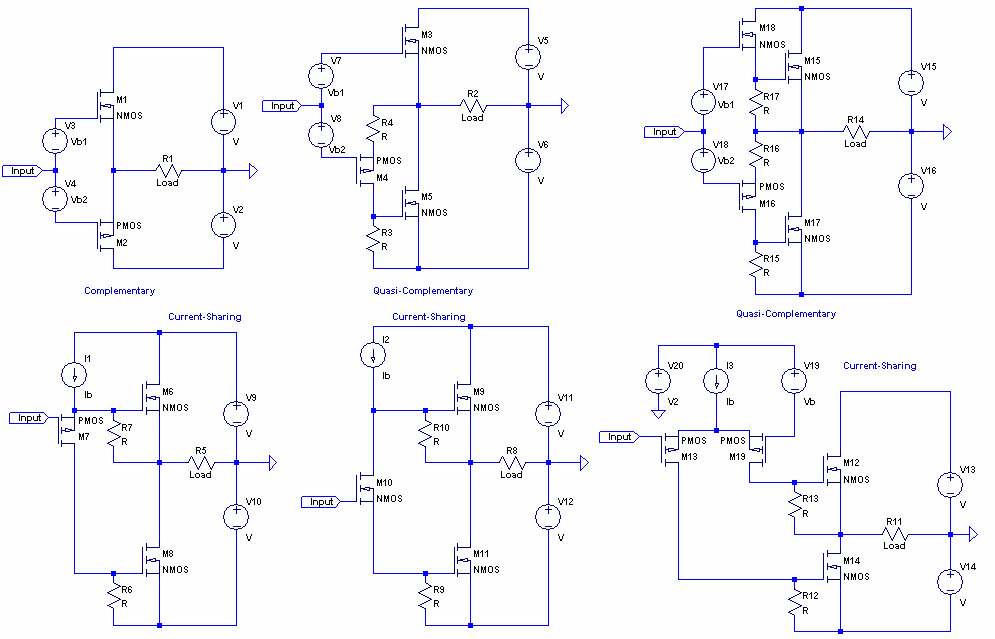

X-pro's Quasi or "current sharing" is circlotron (almost)
I am not sure whether this should be the start of a new thread or not, but I will propose that the output topology used by X-Pro in the Creek amps (5350 4330) are essentially equivalent to a the output topology of the Circlotron (aka. floating bridge). The main different is in the phase splitter. If the output stage gates of both topologies are driven transformer coupled, then they are equivalent except for various parasitic elements that are never modelled in Spice simulations.
(This is my first attempt to insert image attachments in a forum message, so I apologize for some likely formatting problems.)
Figures 1a and 1b illustrate the topologies. Their only difference is the order of the power supply in the two current loops. With the transformer coupling, this ordering is irrelevant.
Usually we want to avoid transformer coupling (and sometimes avoid capacitor coupling too). Therefore we must have drive circuits for gates of the output FETS which have low distortion properties.
Michael Rothacher's paper "Build the the Amazing FET Circlotron"
http://www.passdiy.com/pdf/Build The Amazing FET Circlotron.pdf
Below is Figure 7 from that paper showing the totally symmetric (identical) drive circuits for the two output FETS. This cct requires balanced inputs, which will usually necessitate a proceeding phase splitter stage, thus creating an assymetry in the overall cct.
Alex Nikitin's paper "N-channel D-MOSFET output stage with improved linearity" http://www.ant-audio.co.uk/Theory/N-channel D-MOSFET output stage with improved linearity.pdf shows a Quasi (or as Alex prefers) "current sharing" output stage with several different optimizations of the driver stage. Here is the variant that is used in the Creek 5350:
My claim is that the two topologies are nearly identical, except for the phase splitter parts of the circuits. If the phase splitters can be designed to minimize distortion (and other potential problems), then there should be no difference in the performance of the two topologies.

Alex,
After going through the topic in more depth. I agree with you that non-complementary and Quasi-complementary have substantial difference in way of their working and emulating reflected impedances at output. Thanxz for teaching me with nice explanations and clearing my ignorance.

Hello Hugh,
Long time no see ,
I tend to differ here, in the above examples given by Alex, the output impedances are highly balanced if compared to the usual quasi-complementary, because of the feedback. Also if the outputs are configured as VCCS then also you will have balanced case of impedences.
Correct me if i am wrong, but after having simulated the VCCS stage[my own version] in open loop, i am not getting H2 which is higher than H3.
post12.
What is the difference between "current sharing" and Quasi complementary?
In the current sharing figure: The Drain of Lower output mosfet makes connection with the Source of P-channel input driver mosfet, which in a way provides local negative feedback and linearizes the full output stage.
Kanwar
