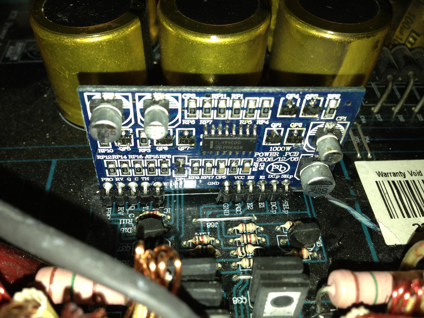

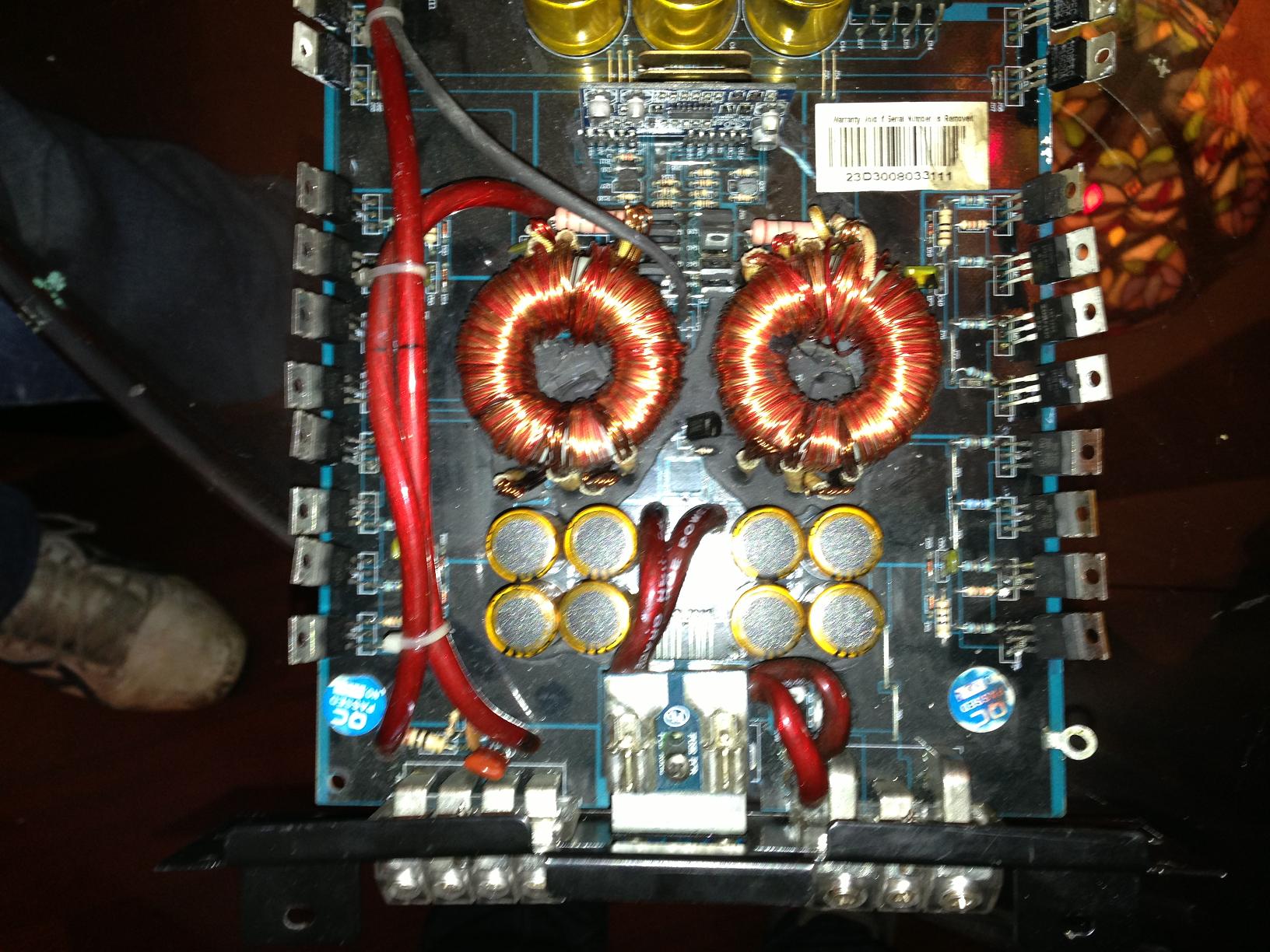

Replaced all power supply fets and drivers..
If i power the amp up it will idle fine for 1 to 2 mins then draw excessive current and the transformer will start crackling and popping ..
If i twist it i can watch the current draw increase and decrease..
I cant find a short in it..
Also not sure if the transformer would cause this but the power supply driverboard get very hot when the amp draws current..
Should i unsolder 1 side from the board to see it i can find the short or whats the best was of doing this??

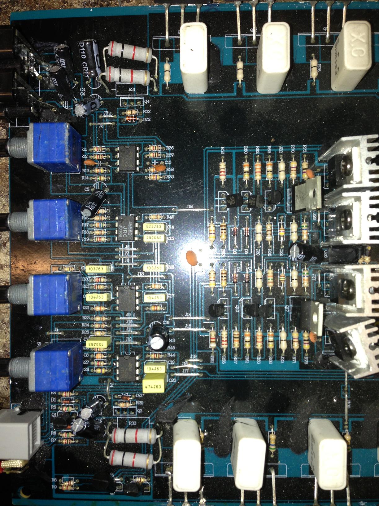

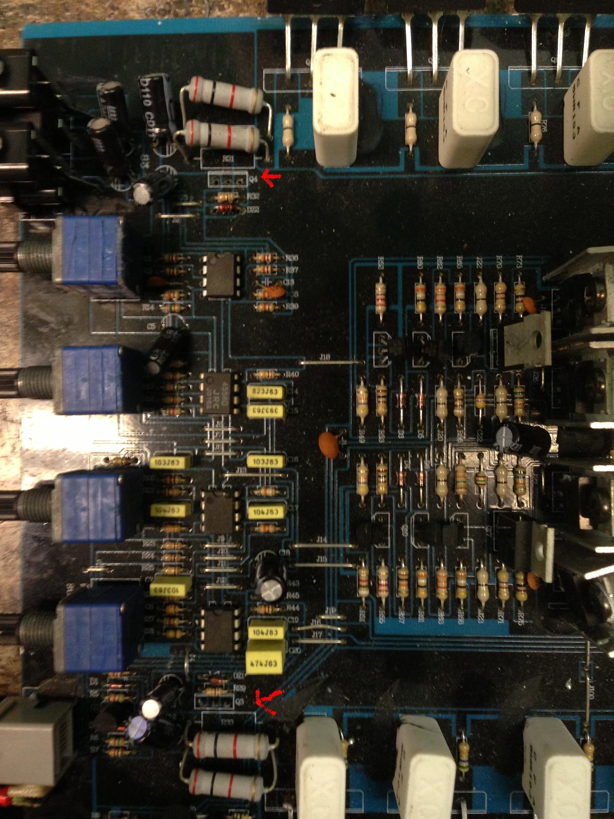

I got the amp to idle fine for now..
Problem im having with it now is i have 2.03 volts on pin 8 of all op-amps and have 53.6 volts on pin 4 of all op-amps..
The regualtors are D669A and B649A ..
Pins 4 and 8 of the op-amps connect to leg 1 of theese Not sure if this is normal or someone has them in backwards..
If this is normal is there a good replacement for them??
DZ1 appears to be the diode for the positive regulator. The striped end connects to pin 3 of the D669.
The other zener connects to pin 3 of the B649.
Check the diodes. It appears that both are shorted.
It also appears that you have a solder bridge between pins 1 and 2 of the B649 transistor's pads.
