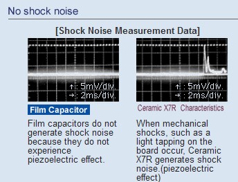

Yet ceramics (X7R, X8R, X8L) are used on PCB's (not for coupling) that have to work in high vibration situations, and where they are tested under vibration. Tapping a capacitor has no relevance to real world operating conditions. These PCBs are used in critical situations where vibration greater than you will encounter in the domestic environment, and standard vibration testing shows that the fears over these caps is misplaced. The only test that will show the extreme effect of the fingernail tap is the ballistic test, never gonna be encountered in the domestic environment.
So X7R etc. MLCC can be used and are used in certain circuit position with no problems or vibration issues, even LDO outputs....
Send your opinion to Panasonic
Read what I said carefully, I have already covered this, shock testing, IN THE REAL WORLD DOING VIBRATION TESTING WE COULD ONLY REPLICATE THE FINGER NAIL TAPPING WITH A BALISTIC TEST.
So under normal operating conditions in a domestic/industrial environment you will not generate these forces.
This is not an opinion it is from empirical data working on certain projects where vibration testing is carried out so that you can be sure the equipment works under high vibration.

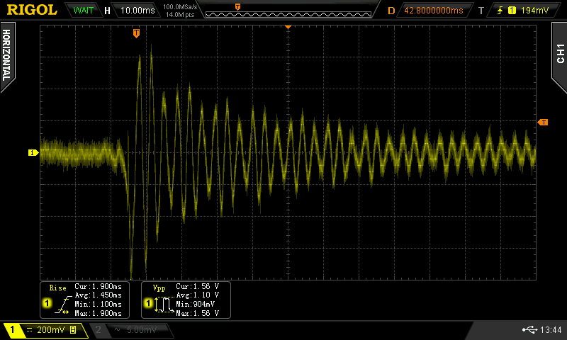

The output of a LDO with some minimum load is low-impedance, so the capacitors can get piezoelectric and dump some charge into it, the LDO is going to do its job.
I've found a nicer way to generate some vibrations... there is a 330 ohm thru-hole load resistor on the board, with long legs, so I pluck it with my fingernail and it goes "twangggg" like a little guitar string. It is much less "violent" than tapping.
First trace is LDO powered off, output cap (10µ X7R) produces ~200µV into 330R load when twanggged, so the piezo current here is < 1 µA. Nothing really scary...
Second trace is when the LDO is powered on, the output moves 1.5 mV pk-pk here, that's a lot more ! It is because the LDO's reference bypass / noise reduction pin is bypassed by a 10nF X7R capacitor. When this one gets microphonic, it injects current into a very high impedance node (VREF), which gives much more interesting output.
If I replace this 10nF X7R cap with a C0G cap, no more problems. The LDO reference is clean, and it has no problems controlling the output, so I won't post a trace, there is nothing to see.
