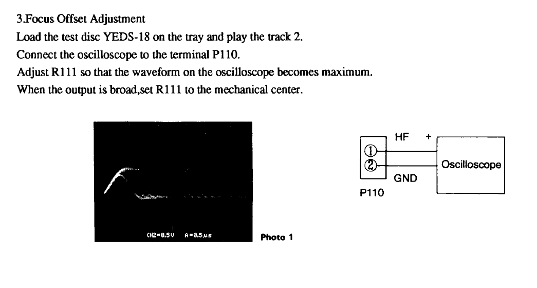

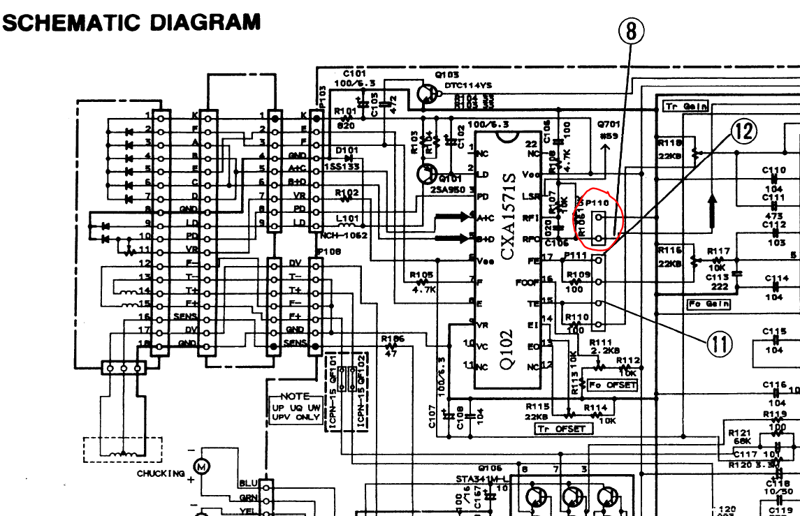

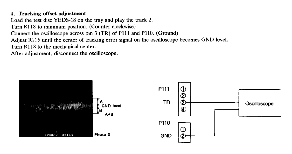

chris;
thanks. i've had some nice onkyo integra series machines for a VERY long time. they have what i consider to be good transports, except the mabuchi spindle motors wear out and have to be replaced sooner than I would like/expect. i was hoping with Salar opening this thread, some useful alternative spindle motors would surface.
The bottom line is it sounds like mabuchi is the lesser of other evils ...
mlloyd1
of course i don't mind you asking.
i don't keep real records, but it looks like every 5 to 8 years.
my trigger is suddenly significantly increased skipping on discs i play a lot.
and i'm not heavy handed on the "Skip" buttons, but i probably was 15 years ago.
while i'm here, if the service manual doesn't specify platter height and I suspect that somebody mucked around on the machine before i got it, what's a good way to "correctly" optimize height for a onkyo dx706 (or similar machine)?
mlloyd1
Hi mlloyd1,
Okay, you're getting the average expected life from those motors.
Does the manual mention anything about the focus servo offset? Some machines use a 0 value while others may specify 100 ~ 200 mV DC on the focus test point. What head does it use, as that will determine the height of the disc table from the top of the head.
I'm afraid I didn't service that many Onkyo CD players, so I'm going on generalities only. You have the advantage because you have the service manual to refer to.
-Chris
hi chris,
head in these is spu3011 (early production i think) and spu3013 (later production; spu3013 is in mine).
a few snips from the service manual. check your PM for more ...
thanks,
mlloyd1

Hi mlloyd1,
Check the value of R103. Measure the voltage drop and calculate the laser diode current. On the head there should be a printed three digit number, or on the flexible PCB that connects to the head. The measured value should be within 10% of the number printed on the head (which has one decimal place that is not shown).
We are making sure the head is healthy before getting involved in an alignment of a bad head.
The easy way to do this is to find another machine with the same head and measure the distance between the top of the laser head and the top surface of the table. Failing that, there is another method.
Follow all the alignment steps in order. This places the machine in a known state that the manual assumes you are at. If you find your offsets where the manual says they should be, you can relax and just use it. Pay attention to the focus offset DC value in normal play mode. One thing that can happen is that the CD player fails to read the TOC after you have adjusted the focus offset. That means that the table height is wrong for certain. The gain setting should be where you found them to be. Using a good quality, clean disc will do for that test disc.
For gains, set the gain control where the low frequency wave forms settle down and before the high frequency noise becomes larger. Do this for both tracking and focus gain. Hopefully you do not have to correct the diffraction grating. That is pretty a fiddly adjustment. A special tool is required to adjust that, so you are off the hook.
Let us know how this goes for you. With careful adjustment, the player will normally operate much better than when it came out of the box. The alignment done at the factory isn't that great.
Good luck! -Chris
