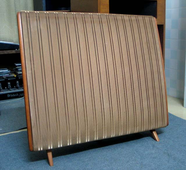

Take the dust covers off, are you serious ?
I really don't see why any one would want to remove the dust covers, with the shortening of their life time before repairs. For Quad 63 and later models, it is quiet possible that the speakers sound balance may be changed, and you may need equalization to resolve this if you remove the dust panels, but once applied that it may indeed sound better, and some people who have an operating theater clean room might get some benefit, but my expectation would be that your speakers will arc, damaging the membrane when playing quieter, progressively until a service is needed. To me this seems a lot of work for little benefit, and some serious problems. Particularly as resale value will be reduced and these speakers have very high re-sale value with undamaged pannels.
That said people who built their own electrostatics may know better.
The Quad ESL57 model, well, removing the dust panels would in my opinion be a foolish thing.
Provided you don't want to go loud, and you don't want to play stereo to many people at the same time (Common electrostatic design fault only partially solved by later Quad models), unbeatable styling.
I think the ESL 57 with suitable amplification, (Eg Mcintosh/Radford amp) is like having a Rolls Royce Phantom V
rather than having a modern Bentley Continental GT.
Maybe the ESL 57 in its original 1957 Golden brown is not the last word in HiFi.
But close to the last word in stylish especially if coupled with slightly impractical valve amplifier HiFI.
I bet the Quad ESL is a little gem with a Mcintosh 40, also one of the most stylish HiFi items and an icon of its time.
Though for real quality you might be better of with a Radford amp.
Of cause it can be partnered by the Quad 303 with remarkable results.
but many other amplifiers will not match its difficult load, and if they do, deliver power that could destroy these wonderful sounding speakers.

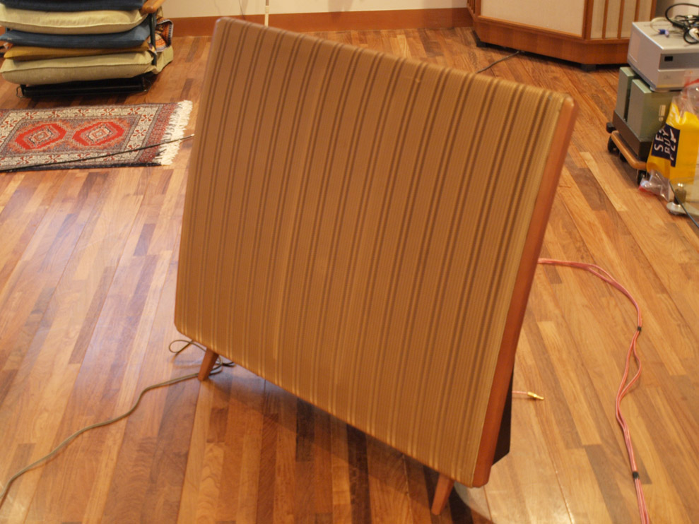

You can even make it perform better and look more stylish too, fitting a new frame will no doubt improve the ESL57, and some might say improve its looks.
{credit quad-musik.de}
I am of mixed feelings but over all convinced if done with enough style, and not irreversibly and I am sure an improved performance would be the result.
{credit www.methe-family.de}
Would you really want to fit a nitro injection to a Rolls Royce Phantom V and risk burning out the valves, I think removing the dust covers in this case is a similar mistake. When simpler and better upgrades could be done. Also see this thread.
I am sure similar stand artistry could be done for the ESL 63 and later. I have already put my ESL 63's on rotating stands. I will make further stand improvements in time, but portability is a consideration, and I do have ESL 63 transportation boxes.
I have not ESL 57 transportation boxes which is why the ESL 57 are still in the United Kingdom, and I have never done a side by side comparison, but I suspect I like the ESL 63 is a better set of compromises, but the ESL 57 wins for looks like a Rolls Royce Phantom V.
