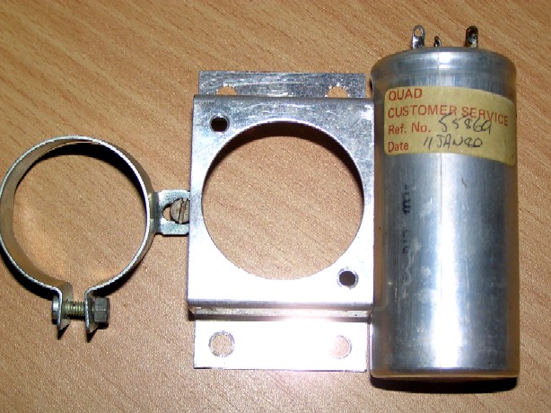

If they are indeed paper-in-oil then there are some questions to be answered, such as:
Why does the original Quad II diagram show them as electrolytics?
How, when an 8uF 600V paper-in-oil is so big, did Quad manage to fit 2 x 16uF 350V in a can half the volume?
The X-ray clearly shows tubular capacitors inside the can, losing further volume.
Harking back to the earlier comment about etched foil, that's only pertinent to an electrolytic.
For info: I believe this is Quad II approved replacement part for the mains smoothing cap 2 X 32uf /450V

Quite right. They are electrolytics. There are three terminations on the can: two of them have a red collar, and there is a common ground, which is black. What baffles me is I remember reading some time ago that one of the praiseworthy features of these amps is that the smoothing caps are paper-in-oil rather than nasty electrolytics. As you've pointed out, on size alone they couldn't be paper-in-oil. Right now I'm holding a Dubilier 4uF 100V paper-in-oil cap and it is large (62mm x 52mm x 30mm).
Whoever wrote that was probably confused by the fact that the can style (shape, fixing, paint colour) is exactly like a TCC paper-in-oil power capacitor.

The power supply caps are electrolytic ; I too imagined they where paper in oil but when replacing them found they are electrolytic. i have never seen a Quad that did not have tar coming out of the power trans. Read of a blind test comparing the Quad 11's to the 33/303; I don't know how they did it the 33/303 is so noisy, compared to the Tube amp. the Quad is excellent for back ground music no dynamics and poor frequency response." very pleasant listening"
