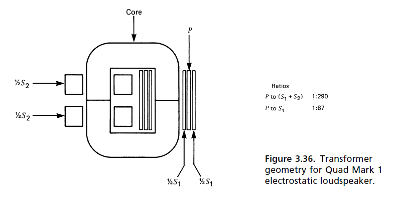

Quad ESL57 input transformer ratios
I have not personally measured ESL57 transformers, but the transformer design is discussed by Peter Baxandall on pages 169 – 179 of “Loudspeaker and Headphone Handbook”, J. Borwick, Ed. The ratios stated were 1:87 and 1:290…pretty close to what stokessd mentioned. Further details on the transformer parasitics and filtering of the different panels is also discussed in detail in the book. I short summary was posted here: Explaining the Quad ESL-57 Crossover
FWIW, my measurements of the ESL63 transformers match well with the data provided by Baxandall in the same book, offering some level of confidence in the ESL57 numbers.

Thank you Sheldon. That was very useful as I had several ESLl57 giving different (and varying) output for the same input. I eventually stripped off all crossover components and measured the three secondary windings. One (pins 3,7) has a ratio of 1:99, is centre tapped to earth (pin 16) and drives the treble units. The two other windings(Pins 1,2 and 4,5) have a 1:95 ratio. All three windings are connected in series to drive the bass units so the bass ratio is 1:289 Readings are averages of three units.
I then added new crossover components to one unit and got the following voltage ratios Mid Treble (blue wires) 1:96 High Treble (brown wires) 1:50 and Bass 1:289
Thank you boiserst. Lovely to know there is definitive information somewhere and that my measurements were not too far out. I have been meaning to get a copy of “Loudspeaker and Headphone Handbook” for a while. That clinched it so waiting patiently for the postman now
Could it be that the original intention was 3 x 1:100 windings, and the actual measurements come from manufacturing tolerances?
I doubt it. I am certain that my measurements are a) limited by equipment and skill and b) carried out on actual transformers which are subject to manufacturing tolerance.
I am equally certain that the ratios quoted in “Loudspeaker and Headphone Handbook” , which I now have, are correct because they match with information I have found in other old articles.
Also I am now in possession of a few more transformers which measure (on average) 3 windings of 96.5:1. Furthermore the secondary windings have around 10,000 turns so to have a manufacturing change from 100:1 to 97:1 would mean the automatic winding machines miscounted by 300 turns - very unlikely.
Regarding manufacturing tolerances the widest difference I found on six transformers was less than 1:0.4. so I guess my 96.5 would be within manufacturing tolerance of 97:1.
The other reason why I have a slightly different ratio is that I tested using standard un-calibrated multimeter at low frequency
