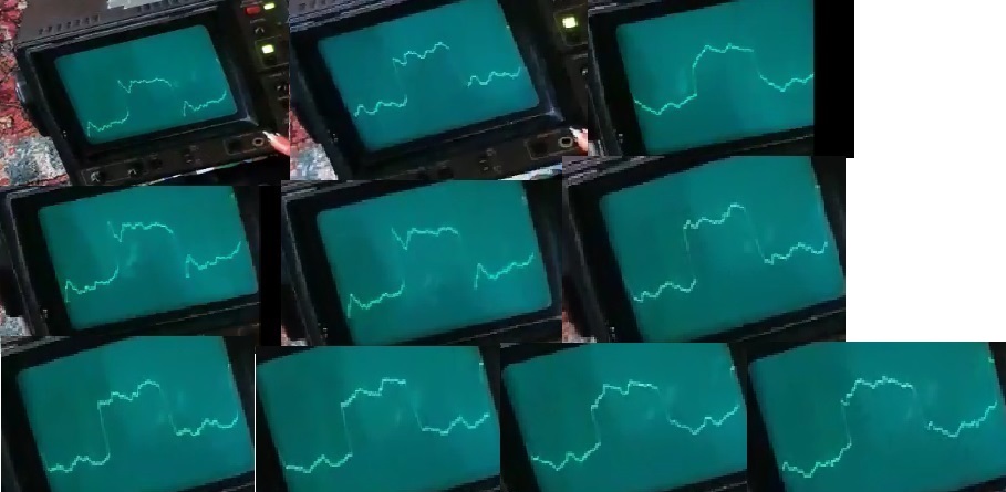

First a measurement of the square wave response of a sligtly modyfied ESL63
As you can see it´s not perfect.. but in the video I will show you what happends when the microphone is moved around 1" or 2,5 cm...

Instead of video here is some screenshots, unfortunately i don´t have my own unechoic chamber so when the microphone is moved around you will see how much the room actually is contributing. I tried to reduce reflexes from boundry surfaces a little. Behind the speaker there is another room that is well damped, and in the microphone surrounding there is some dacron panels.

btw that square wave being higher in the middle and not drop instantly does it not mean it lost some of its high frequency component ?

Since you are working on that Sisyphean task, you may want to consider some measurement software. It will make your life a whole lot better. You'll want to use a MLS or swept sine quasi-enchoic impulse response to get the room effects out of your measurements. You'll be able to see what you are doing and not constantly being confounded by your room interactions.
