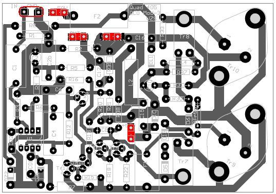

I would suggest some minor modifications to this pcb, concerning the input/output connectors and the decoupling capacitors.
1. Use of other kinds of connectors for power (+-50V, GND) and speaker out. I used 1.2mm pins but those seems thin when you have to solder heavy wires to them. I would suggest using something like this one Faston FS1536
2. Make closer the input and signal gnd, now they are 7.5mm apart but making them 5mm apart you could use some 5mm connector instead of soldering pins.
3. In parallel with C15/C16 decoupling capacitors it would be nice adding some 100uF and RC snubber across them. I'm afraid these would fit only on the solder side, but will see...
If you are not in a hurry I will do the first two mods to the pcb early next week.
You can see what I mean with the 1 and 2 in the attached image.
There is a whole debate on where the speaker return should go in the "Bob Cordell Interview: Power Supplies" thread, somewhere at the beginning, you should check it out.
Some clarifications on the, not so successfully, naming I've used:
GND should be rather signal ground and Earth should be power ground.
I've done the following connections:
IN - GND -> shielded cable coming from an isolated RCA. The shield at the RCA side is connected to the safety earth to minimize earth loops
+-50V -> filter capacitors
Earth -> board decoupling and other signals whose return should go to power ground. This is connected to the common star point on the PSU.
Speaker ground -> also connected to the common star point on the PSU
Out -> speaker out
I've followed Douglas Self recommendation on how to implement grounding from Audio Power Amplifier Design Handbook - pg. 402. Try to find this book somewhere or send me a pm
Regards

@RogerGustavsson
Yes, I noticed that Keith Snook have added some other modifications like the current source for Tr8 and complementary outputs, however, If you like these heavy modifications and want to try out something new I would suggest looking at the modifications suggested by tvicol in the thread: QUASAR a QUAD405 reborn design
Regarding with the minor modifications, what would you like me to modify? I will modify those in/out connector modifications I've said, what else?
Unfortunately I don't have as much time as I had when I've did these pcbs last year. I could send you the project files if you want to do it by yourself.
With the ordering, as I said earlier in this thread, for 2 pcbs it cost me ~45 euros. If I would like to send it to you it will cost you even more, so try to find some pcb manufacturer in your country and I can help you with the files needed by them.

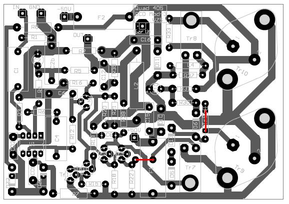

Nice Zsolt!
I have reworked my PCB. It now incorpates some more of Bernd Ludwig's original modification. I have placed a couple of transistors in the supply lines to the IC. That should remove some noises during power off. According to Bernd, only the one in the minus supply (Tr11) should do the trick but I have followed his first modification. I have also removed Tr3 and R18 as proposed by Keith Snook.
Keith Snook wrote: "The increased open loop gain using - 2SA1085E - 2SC2547E - ZTX753 - or any simular "modern" devices is more than enough and with Tr3 fitted you may find you have an RF oscillation which will not show on a scope but the distortion will be slightly higher and Tr7 - Tr8 will run hot - also it can cause blocking of the dumper drive which appears as clicks or sometimes a burst of oscillation on the negative cycles which can be seen on a scope."
I have retained the original DC-clamp circuitry. I know that Dada Electronics will have its new protection board available soon but I find it too expensive (45 Euros/channel). Those who wish can just leave the DC-clamp components out. My layout are using small Picofuse soldered directly to the board. That leaves space for some larger value capacitors in parallel to C15/C16. R30/R31 are placed on the back of the board, C10 stays cool that way. This is my latest drawing:

It's a good idea to have some supply line transistors to the IC, I will add them.
Indeed, leaving Tr3 in it's place increases the risk of oscillations, however, if everything is done right I think it will not oscillate. Just see that Quad has added back Tr3 in later versions as Quad 606 or Quad 909. I think they wouldn't did that if it's a problem.
Anyway, if somebody has oscillation problems, than he can take it out and use a strap instead.
Tiberiu Vicol (tvicol) raised my attention to the fact that by removing Tr3 and using the current source he suggested at Tr1 (Tr1a, Tr1b) will not be ok because:
Vce Tr1b= Vbe Tr7 + Vbe Tr3 - V R15
but
V R15 = Vbe Tr1a = 0.6V
results
Vce Tr1b = 0.6 + 0.6 - 0.6 = 0.6V which is too less.
So, Tibi's suggestion would be a diode before Tr7's emitter and maybe a capacitor over this diode. This way Vce Tr1b would be ~1.2V
So, if neither of you wants to use Tr3 than I will take it out and add a diode at Tr7's emitter. I will not add the DC clamp to the board, as anybody can buy a Velleman K4700 for ~20euro which I think is far better then Quad's dc clamp.

vzs said:...
Zsolt,
QUAD have added back the triplet in 606, 707, 909 etc, but in the same time the gain of class A stage was increased considerably.
In the original 405 the gain of class A stage is only 500/180= 2.77. Class A triplet gain is huge and this is the main reason for oscillations, but not the single one.
In 909 the whole gain of the amplifier is dictated by class A stage and was set to 500/7.5=66,(6).
Because in DCD versions, Keith Snook have decreased the gain of the OP amp stage, you can increase the gain of class A stage to 500/100=5. This will ensure a better stability and will set total gain of the amplifier to ~ 31dB.
My advice is to use a dublet and to increase the gain to 5.
Tibi
@tvicol
Correct me if I'm wrong, but isn't the voltage gain of the class A stage=3.77 ( 180/(500+180) )?
I could change R16 from 180 to 130 and the gain of class A stage will rise to 5.
Why increasing the gain of a class A stage improves the stability of the amplifier? (maybe it's a beginner question but I'm a beginner in analog electronics theory)
By increasing the class A gain to 5 the gain of the whole amplifier will rise. Should I reduce the gain of the opamp stage to maintain the input sensitivity to ~1.5V for full output?

vzs said:@tvicol
Yes you are right. In fact (500+180)/180=3.77
Increasing the gain the amplifier will sound also less compressed.
You don't need to reduce the gain of the opamp. This was already done by Keith.
