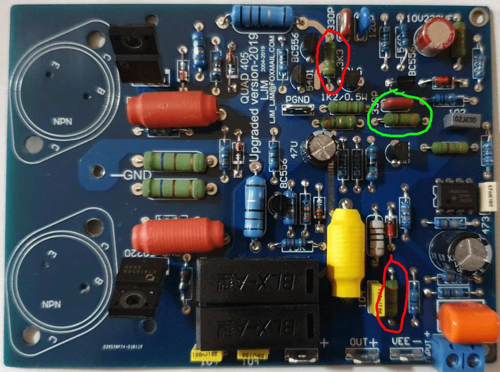

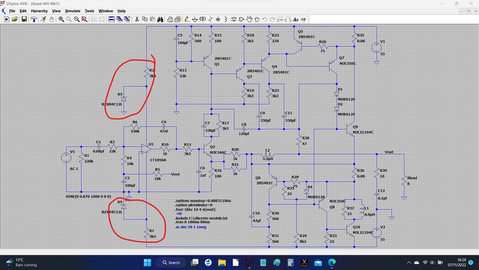

To me it looks like the ones highlighted in red, they are 3k3 in the original circuit. There is an additional 3k3 shown in green, but this looks like it is the one in parallel with the 330pF capacitor, so not the opamp supplies.
Thanks! Is the zener diode 12 volt?
Mooly said to calculate the current : " If you have a 50 volt rail, a 2k7 resistor and a 12 volt Zener you have 14 milliamps available calculated as (50-12)/2700 "
In this case, if the zener diode is 12 volt, the resistor is 3300 ohms, the supply voltage in this case is +/- 40 volts, then that makes ( 40-12 ) / 3300, so the current should be 8ma

If you want to use an opamp that pulls 14ma with 40 volt supplies then you need to drop the resistors to 1.2k 1 metal films. Those will run quite hot dissipating around 650 milliwatts each. 1.2k gives you 23 milliamps which allows 9 milliamps for the Zener.

Thanks! Where are the resistors? I can't see 2.7k ohms on the circuit diagram. Can you please mark on the photo below.
Administrator
Joined 2007
Pin 4 and pin 7 should have direct continuity to one end of the resistor and also the Zener. That means it should read zero ohms. For example in this diagram pin 7 should have direct continuity to one end of the Zener D1 and one end of the resistor R7.

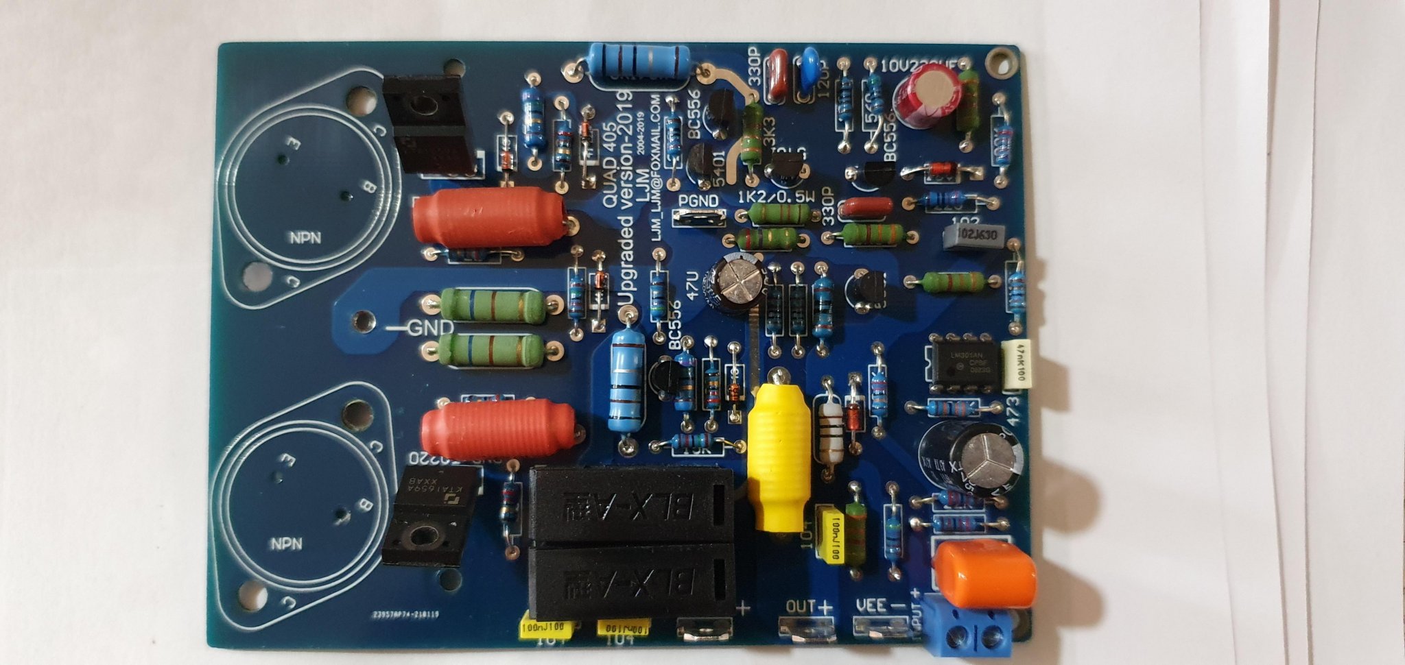

My Quad405 clone is a heavily modified ebay module. (I posted here some time a go)
