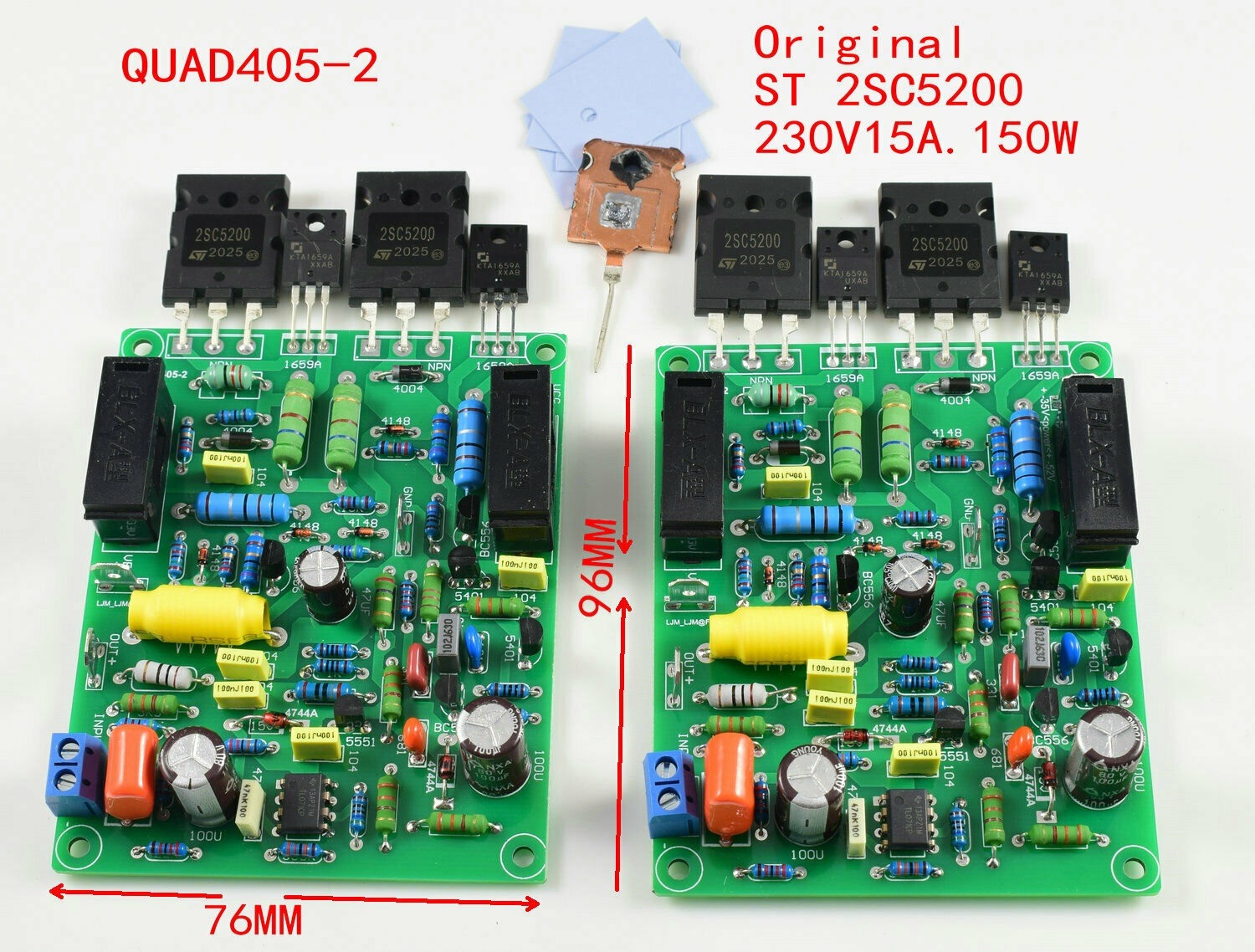

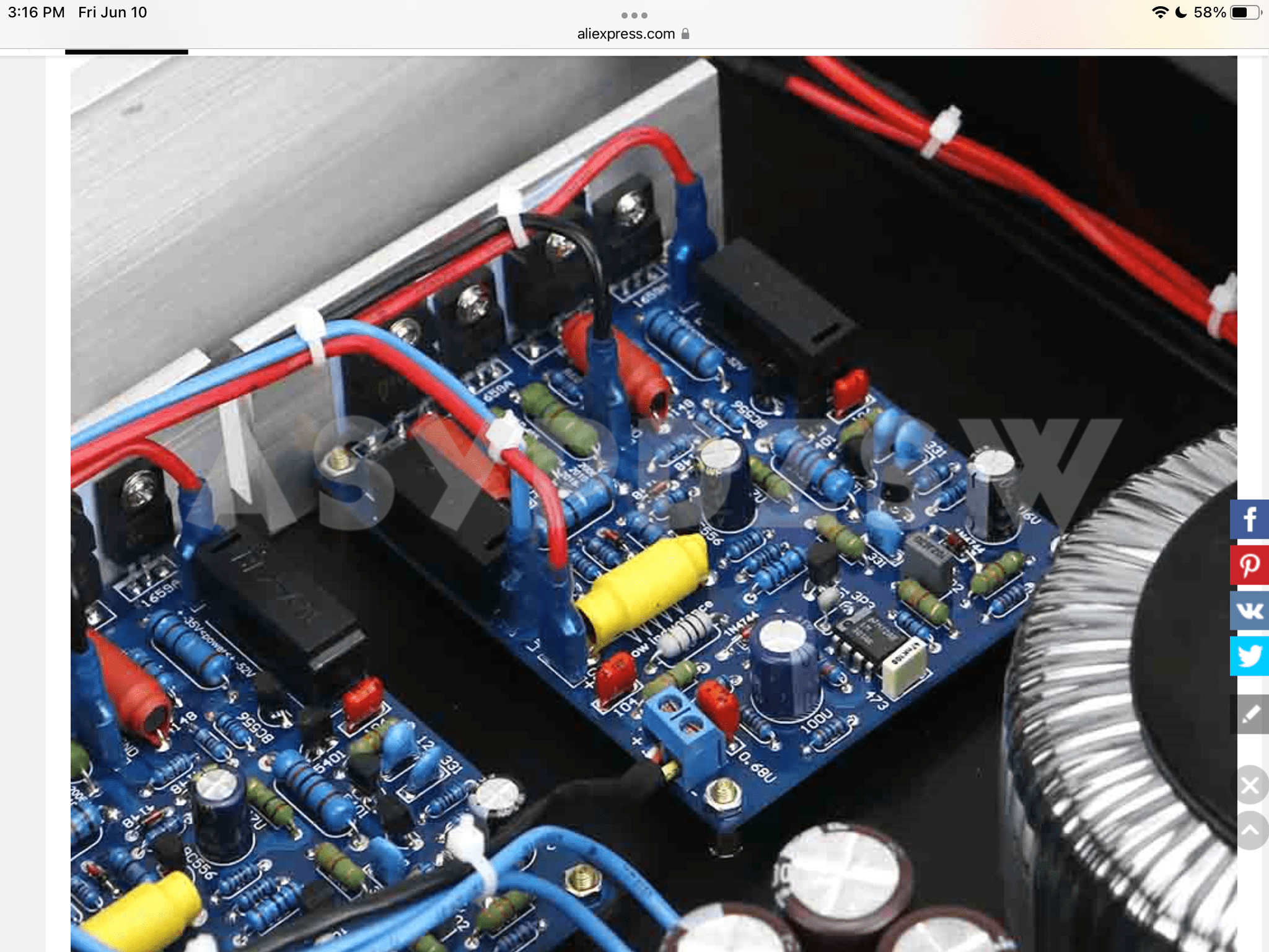

Saw these accidentally, maybe another version of it, the tiny heatsink will be OK?

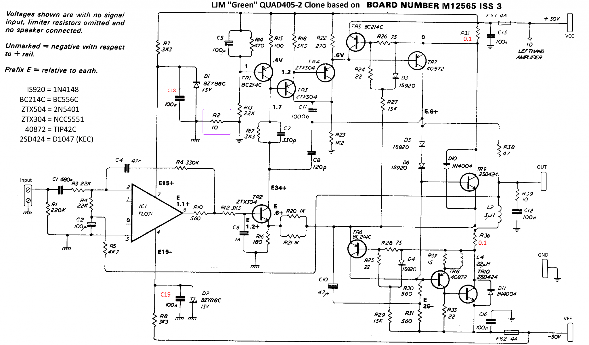

The first attached schematic is what someone else created for the LJM Quad 405-2.

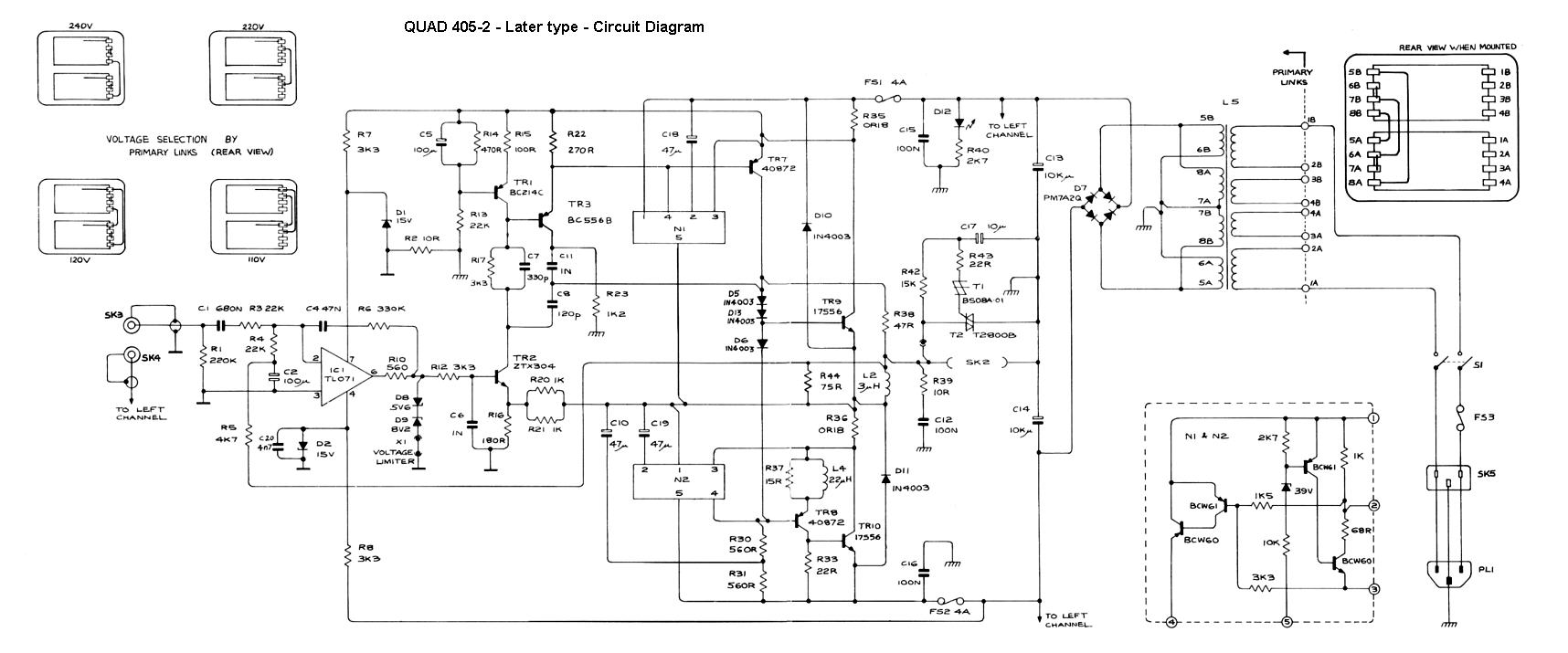

The second attached schematic is the Quad 405 MK2 schematic. (At least what I found online.)
Does that seem right? If so, it has D13 (as labeled in the Quad 405 MK2 schematic) but does not have the diode between the bases of TR9 and TR8 (of the Quad 405 MK2 schematic.)
