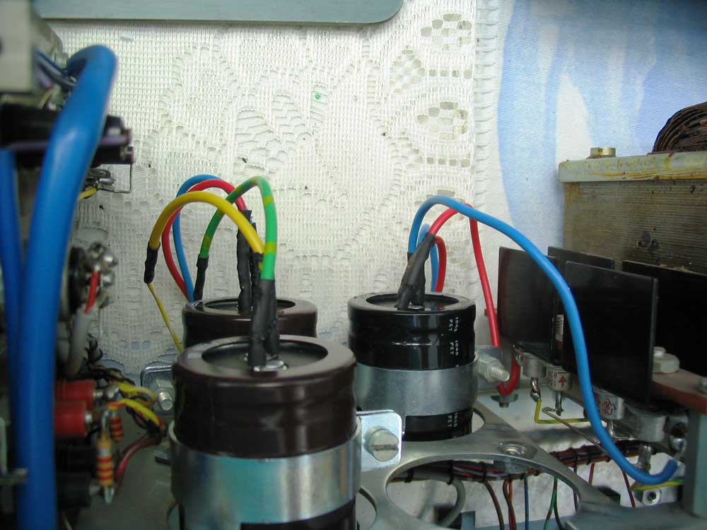

I have three 303's two have recently bee re-built to varying degrees using DADA supplies.

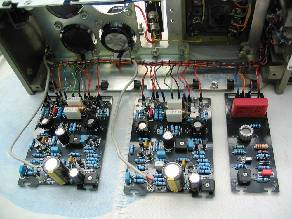

I've bult several 303 clones but with some mods. The best was to use new epi 3055's and most of the HF roll-off capacitors could be halved. Performance improved from the standard 35 kHz with original capacitor values and RCA original transistors to over 70kHz, using ST 3055's (but I suspect ON semi would be similar) and (at least I thought so) sounded better for it.
John
I did a true esoteric renewal of 303, upgrading all except the original casing and transformer. Epcos, Elna, Wima, RIFA & SMica Caps, Bourns trim, Kiwame, Mills & Takman resistors, ON Semi 15030/31 + 15003/4, J507/510, Van Den Hul cs18/16 wiring... But, the new metric screws are not matching to the old ones!!!
Does anyone know where I can find new screws for 303 (4BA thread)?
