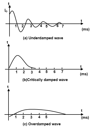

Even more interesting, in control systems terms (one of the engineering fields I studied too many years ago), any system with a "Q" of less than 0.5 is actually considered to be over-damped, i.e. *** takes too long to return to its rest position when disturbed *** . As this describes a significant amount of bass drivers available (Qts<0.5), one could argue that many of them are actually TOO damped until they are put into an alignment that drives that "Q" up. :)
True, though only describes one aspect of how badly it can distort the transient.
GM
