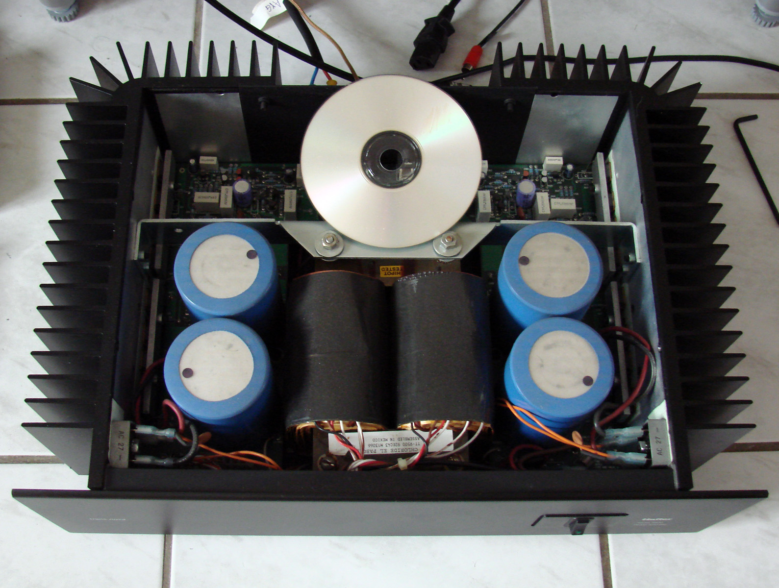

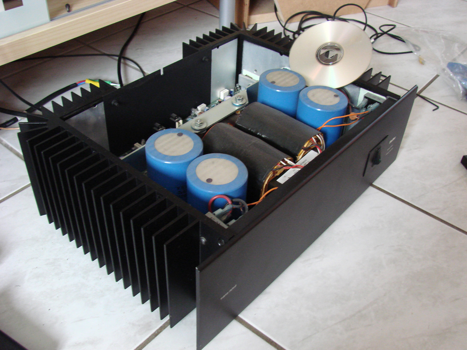

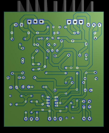

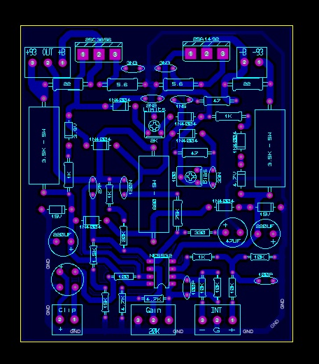

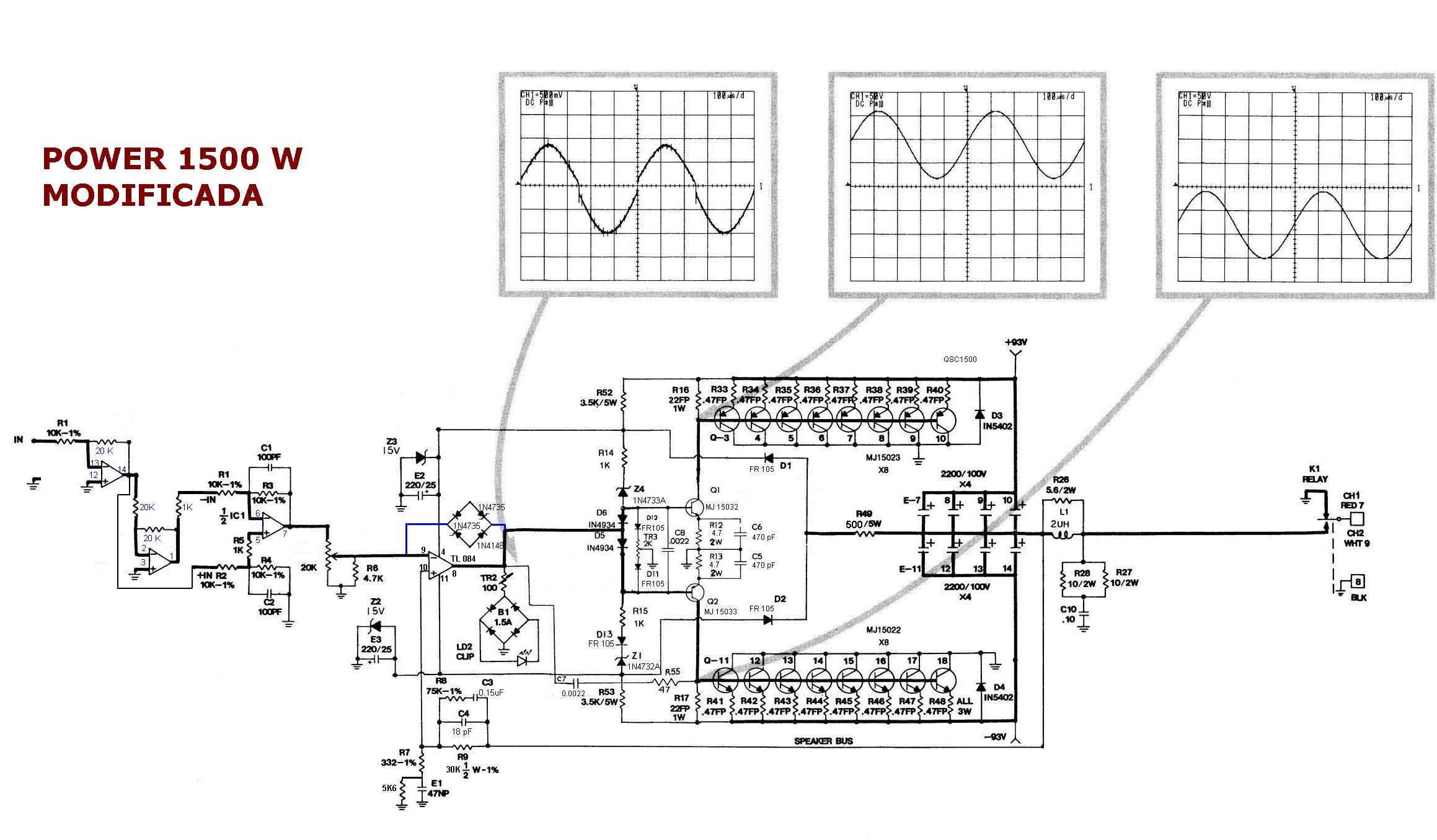

GROUNDED COLLECTOR QSC
Some qsc clones grounded collector many diyers have constructed these amps
warm regards
andrew lebon
