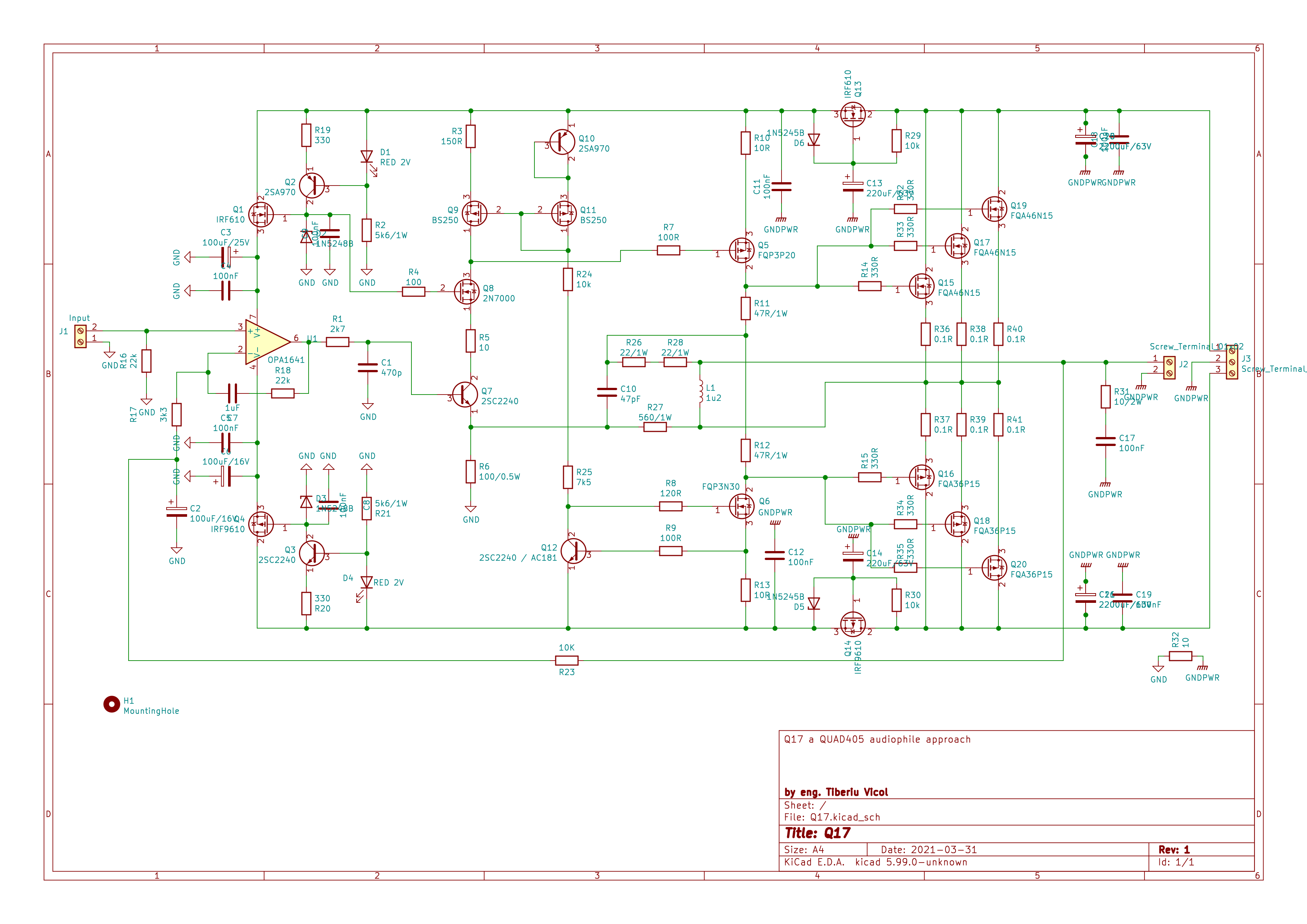

Gentlemen,
Do we have a little high-powered one designed with more number of Output transistors ?
Something like this. PCB coil need to be re-dimensioned or use a normal air coil.

Using drain resistors in final stage will not help to equalise operation of the mosfets. In fact you will increase output impedance and loose power. Usually these "ballast" resistors are used in source in order to correct differences in Vgs and bring all transistors to close operation point. In a class A or AB amplifier you need these source resistors, in order to dissipate power over all final transistors and make them operate at same operation point. In our case the amplifier is biased very close to class A, with very low Ids. You may shunt drain resistors and parallel two pairs without source resistor. One mosfet will open before the other, so you may want to have them from the same manufacturer lot, or to match them with very close Vgs. The advantage of doing so is that you get even lower output impedance with better control over complex speakers.
Tibi

Mosfet gate resistors, named also gate stoppers, are there to avoid any unwanted oscillations. The gate current is too small to have any considerable voltage drop over gate resistor in order to make a Vgs "balance" between transistors.
Now for the source balast resistor: is the same as you put several LED's in parallel. If you just put them without any series resistor, some will light brighter than others. To make them light at the same intensity, you need to add a resistor in series for each one.
Tibi

In your Q17 documentation I read that the output stage (Q15-Q16) is biased "near to class A operation, requiring a large heatsink".
Can you indicate power dissipation of the output devices, based on approximately +/- 50 V supply? In other words: how much DC current is flowing through the output stage?
That will make clear how large the heatsinks must be, right?
Well, not quite my words ...
Near class A is still in class B. Final stage will run in class B and maybe very slightly biased in A (few mA), depending on mosfet Vgsth=gate source threshold voltage.
To answer your question, the DC current trough final stage is so low that can be ignored.
However, they still require heatsink. Not a big one like a class A/AB amplifier. Anything over 200cm2/mosfet should be enough to keep them cool at room temperature.
More precaution should be taken on Q5 and Q6 who are running class A and dissipate ~3W each.
Tibi
