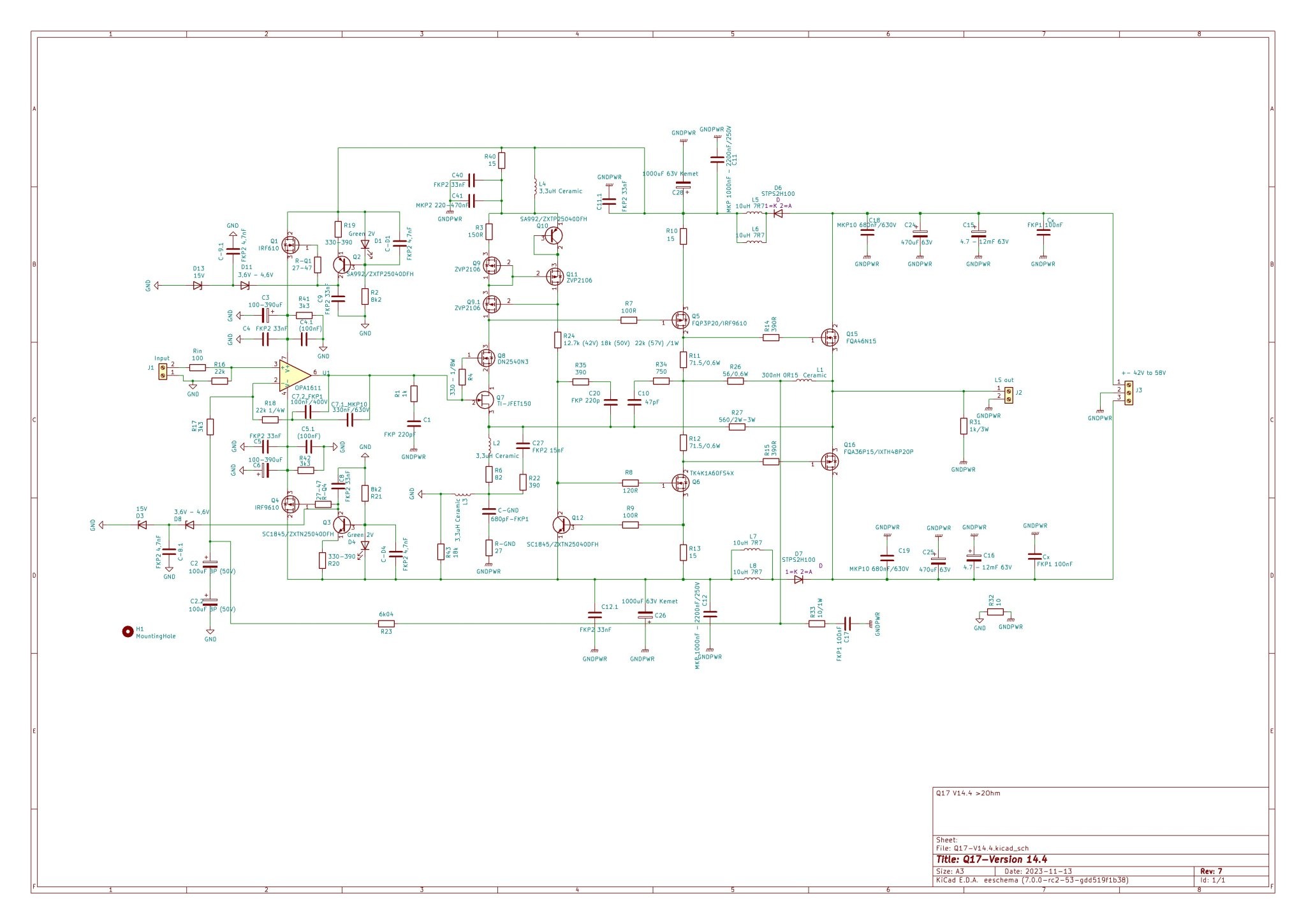

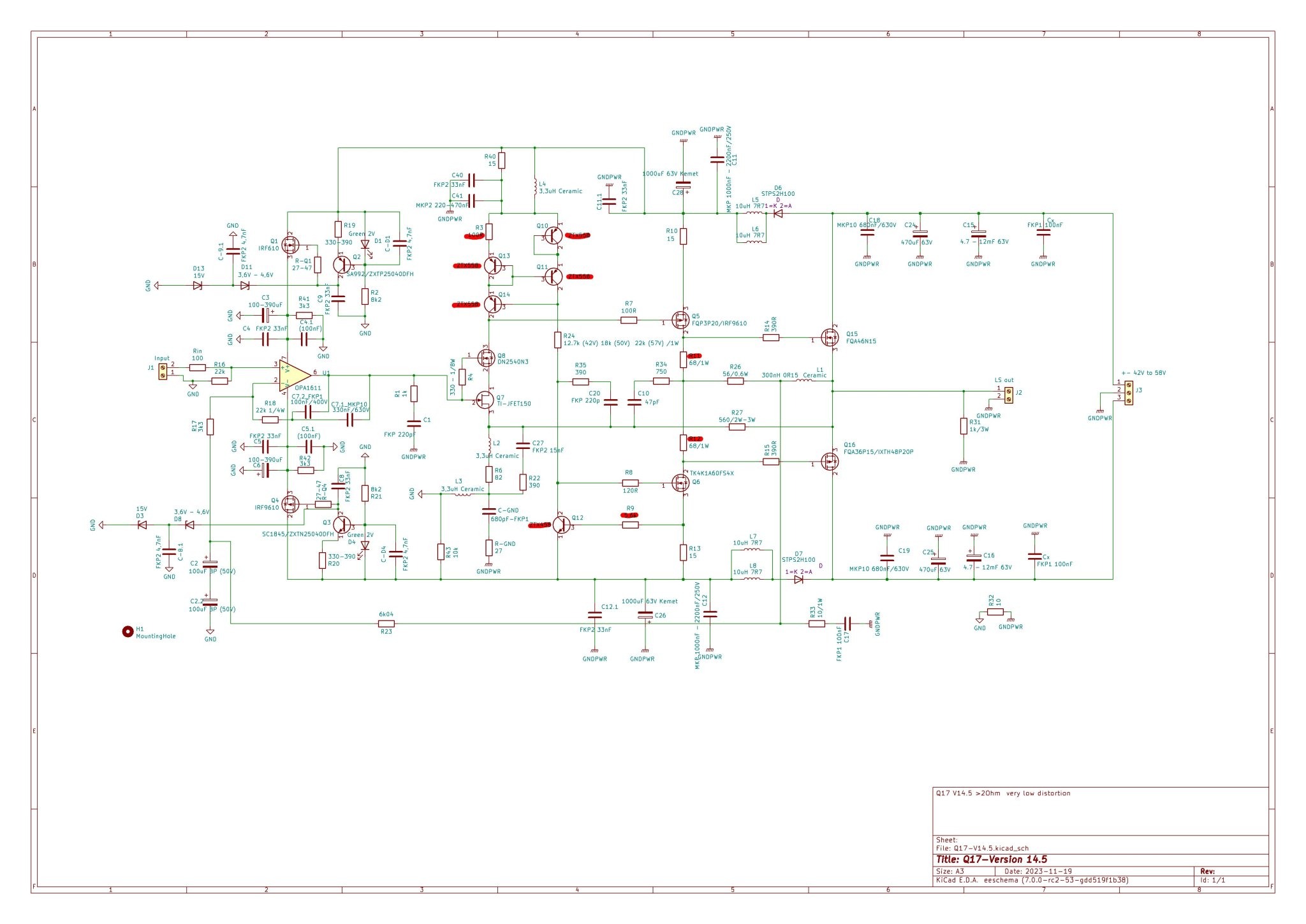

Hello everyone,
I would like to discuss the recent changes to the Q17 and derive ideas for optimization. Originally, a current mirror was formed with Q9 and Q11, with its input current depending on Q12 and R24+R25, regulating the current for the cascode. Thus, it was a feedback correction. The variant from this summer (by Tibi), accurately reproduced by Stef, changed this by replacing the simple current mirror with a Wilson current mirror.
So far, nothing new.
Now, this Wilson current mirror has an impact on the current for the cascode and the currents in the circuit of Q5+Q6. Therefore, it is understandable that Tibi reduced the resistors R10 and R13 to 9.1 ohms. However, the adjustment of R3 is missing. In the original concept with a simple current mirror, R3 was chosen quite ideally at 150 ohms. In the concept with the Wilson current mirror, this value needs to be reduced to the order of 100 ohms for the circuit to work well-balanced again.
Since the circuit is a Class A feedback correction with Q5 and Q6, generating higher impulses when driving two pairs of Mosfets (Q15, Q16, Q17, and Q18 - in Stef's Turbo), there is increased instability in terms of oscillation behavior. I've dampened the oscillation behavior a bit by adding a resistor (R34) to C10 – this suggests that the mica capacitor without a resistor is not perfect (I can demonstrate this in the Spice simulation) and that a high-frequency capacitor with high ESR – like the cheap ceramic capacitors – would be more suitable in this position.
Additionally, I'm damping high-frequency oscillations of the feedback path (Q12 – R24+R25) by adding an additional damping element (R35 + C20) compared to the central feedback (through R27).
Now, in this context, I have determined that R3 is still too high in my latest version (#2,204) and should be adjusted.
During these investigations, I explored the question of which alternatives to Q12 can have a positive influence. In the simulation, I picked up the possibility of 2N5551 and found a solution with a high base resistor (R9). Since I want to keep the quality of the components as high as possible, I chose the ZTX458 as an alternative to 2N5551 (as Q12). As the simulation of the Wilson current mirror behaves little positively compared to the simple current mirror, I also simulated a double current mirror with P-MosFET. Now there is the idea of building all components of the Wilson current mirror, including Q10, with ZTX558. This results in a simulation result that is even more precise than with P-Mosfets.
This adjustment allows a lowering of resistors R11 and R12, making the power stage in Class B almost error-free at the zero crossing.
The reason for this investigation is provided by the Hafer interpretation: https://www.diyaudio.com/community/threads/unusual-amp-from-1987.357369/post-7493521
In this amplifier, the Class B power stage also works very precisely, which the Q17 in its current form does not. However, the described circuit works with extremely small signals, which reduces my enthusiasm. Therefore, I consider it more promising to further optimize the Q17 circuit.
What do you think?
Best regards, Tim

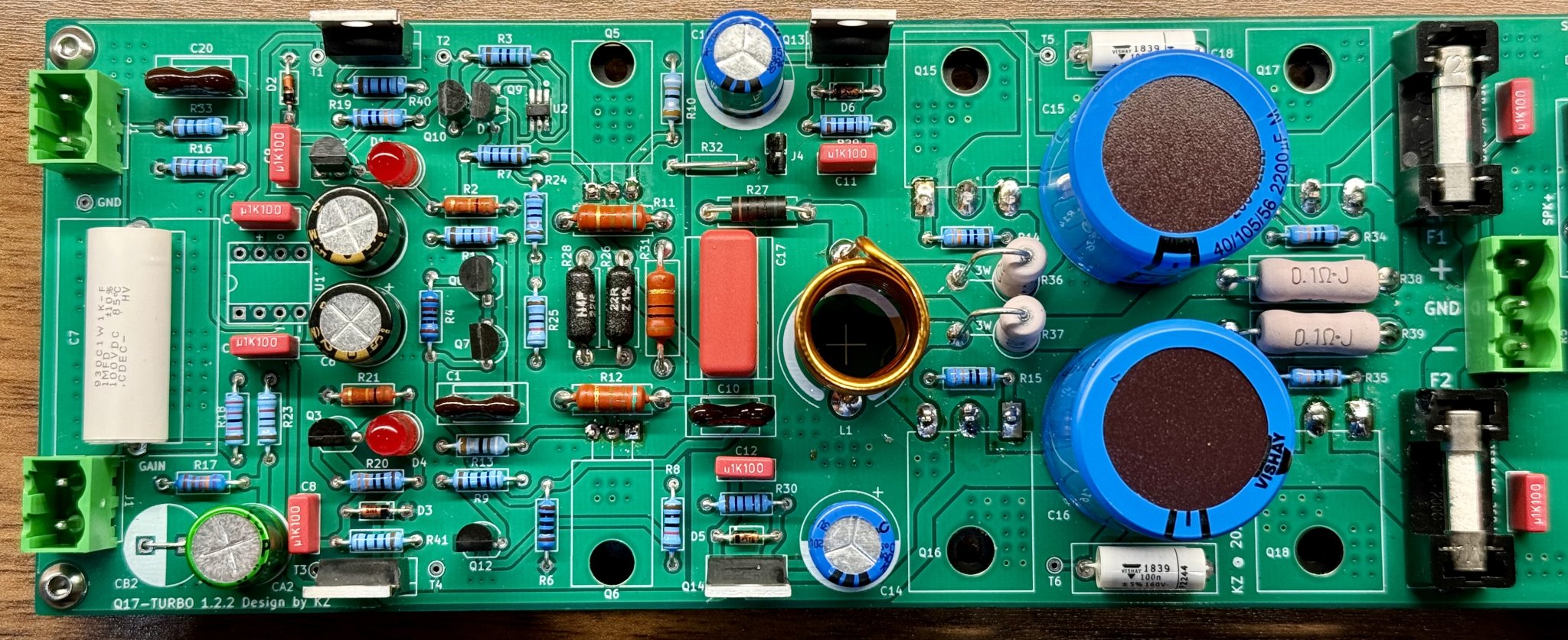

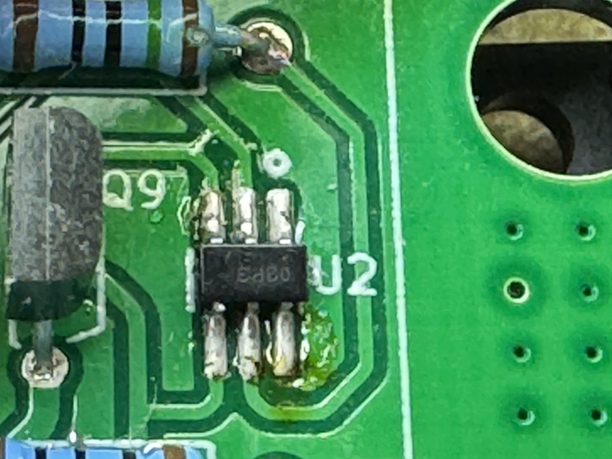

Hello!
I need help...
I built a Q17 turbo 1.2.2.
If I connect the supply voltage (power supply +- 50V current limit set to 1A) then Q16 and Q18 quickly get hot. The LEDs don't light up either.
So I have a mistake somewhere...
Q16, Q18, Q6, Q14 tested.
Does anyone have an idea for me as to what I should check?

Hello!
I checked it.
Very puzzling. Because I have installed the same board twice and have the same symptom.
So there must be something fundamentally wrong...
I just can't find anything yet.
Q1, Q13,Q9, Q10,Q3,Q13,Q5,Q6 all unsoldered and measured, all good
U1 and U2 swapped...
