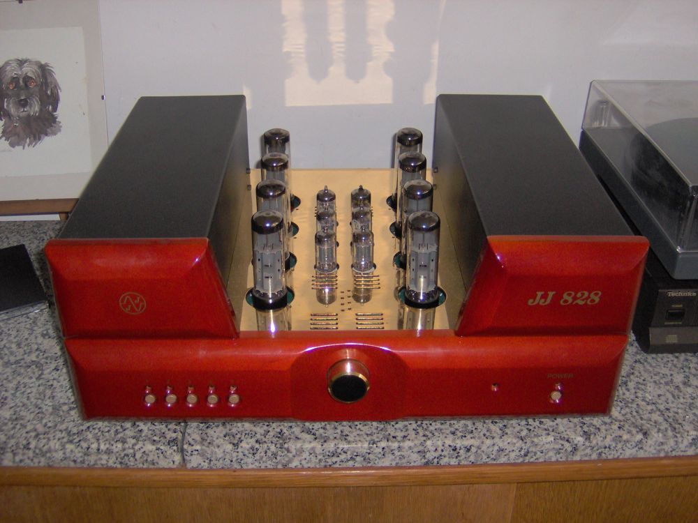

Hi, I removed the lamp and JJ ECC99 JJ KT88 from the amplifier 828 I used ECC82 and EL34 tubes, and is much better. JJ is a Slovak company / before Tesla / and their tubes are not good. Greetings Dinkers
