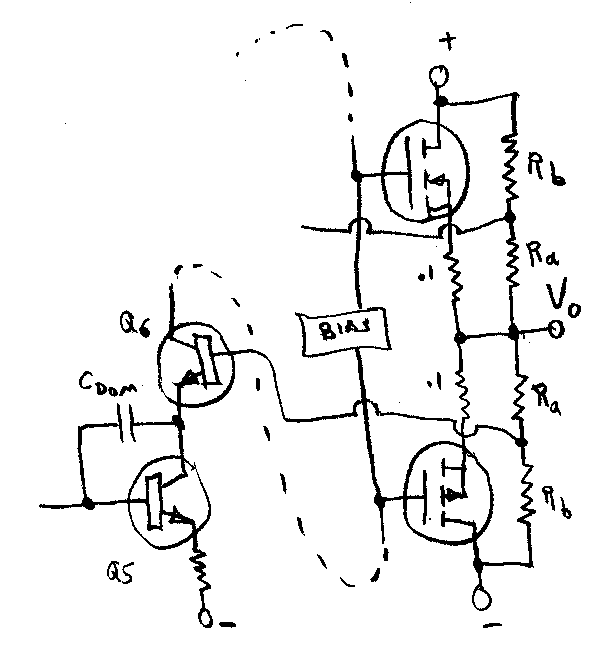

Electron said:
I red again (I do that time to time) old articles about amplifiers.
Ed Cherry writes EW July 1997 "Ironing out distortion" about the miller compensation. He recommended to include the power stage into miller loop. This should lower the cross over distortion.
However D. Self wrote in EW Feb 1994 that this kind of solution will lead easily in to parasitic oscillation and he also wrote that the benefit is minimal if the bias in the power stage is set right.
No doubt that both gentlemen have their point. However the idea was so interesting that I started to figure how it could work with Fet power stage. The Fets generate more distortion, and the cheap "hexfets" or similar has big differences (p vs. n) in conductance over the cross over region.
The Fets are much faster than bipolar which could make them better in the millering what Ed Cherry recommends.
Further... what about if the miller compensation is cut in to parts. One including the power stage and one part as the traditional including only Vas. It could solve the oscillation problem but still probably lower the Fet cross over region distortion and to make open loop distortion lower on higher freqs.
Anyone tested or any opinions ?

I have used IRF641/9641 in my own designs with good results. I used them in hybrid CFP power stage which hides their unlinearity and thermal (problem) well. I am going to include the power stage into miller loop and see if I can keep some how the amp stable.
Re: Re: Re: PWR stage in miller loop
Hybrid MOSFET-BJT CFP power stage unlikely to be stable with inclusive single-pole miller compensation.....No harm in trying though....

V-Fet refers to the way it is built, and is a general classification. the drain source channel is shaped sort of like a V. If you are using FET's that are linear, they are probably constructed similar to this. (see picture)
  • mosfet.zip
