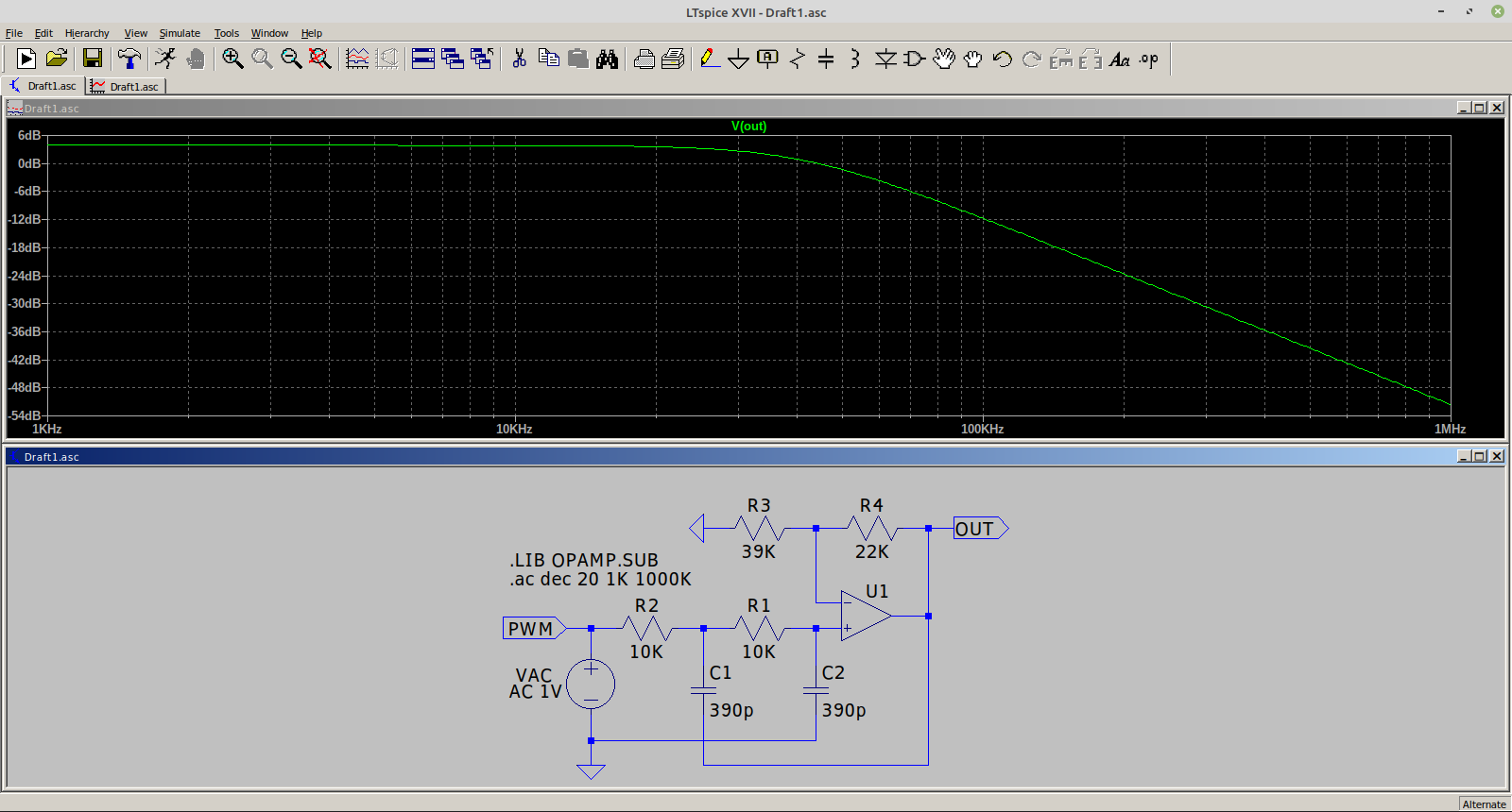

Or... second order low pass set to 40KHz.
PWM to analog with op amp
If I use an op amp IC, does that simply act as a buffer for the following stage following a RC or LC filter, or does the filtering happen in the op amp’s feedback loop?
