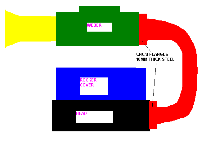

Hey John, how much do you know about fuel atomisation?
I’m probably being a bit paranoid, but I’m slightly worried about fuel drop-out in a intake manifold design I’ve come up with.
I’ve made a few measurements and come to the conclusion that the body work modifications to make the DCOE’s sit next to the head are more than I’d like. I would have to hack up the bulkhead, which is already painted.
I’ve decided to make an intake manifold with U-shaped (rotate that U ninety degrees anticlockwise :) ) runners so that the twin DCOE’s sit above the rocker cover. The 2.25 litre sits a fair bit below the bonnet, so there is plenty of room for them to sit there.
As a bonus this manifold will be easy to manufacture. The intake ports in the head are round with a diameter of 38mm. A can get four lengths of steel pipe with an internal diameter of 38mm mandrel bent into the required U shape by an engineering shop. To mate to the 45mm Weber bores, a flaring of only 7mm will be required. A can easily make a cone shaped wooden dolly to shape the flare, hammered into the end of the pipe after heating the pipe with the oxy acetylene.
I’ve attached a lame drawing of the idea below.
My only concern of for the possibility that the turbulence won’t be great enough for the fuel to stay entirely atomised on its way around the bend, causing a small amount of raw petrol to dribble into the intake ports.
What do you reckon?
Glen
EDIT: And yes I know the carbs will need to be unbolted each time a tappet adjustment is due, but that doesn't bother me.

It would be a crime to hack that bulkhead about, it's smashing.
The tubes should be thin walled enough to heat up fairly quickly so hopefully you shouldn't have much of a problem. Would it be worth getting the insides of the tubes sandblasted? It should give a bit of turbulence in the manifold though I can't decide if it would make matters better or worse.
I will consult with my guru, I'm going round to see him this afternoon. He's bought an assembled Megasquirt from a geezer on Ebay so we are having a play with that today. They look to be a very versatile device, there are loads of adjustments with which to bugger the job up completely!
Tappet adjustment? I've known engines to rattle like a weaving shed for a decade or so before having the rocker cover prised off it, mostly mine.

Thanks John. I wore my knuckles to the bone getting that bulkhead back to bare metal! Not to mention the upper torso and facial acupuncture from the wire strands constantly flying off the twist knot wire brushes.
Any way, sand blasting is a good idea. The fab shop that I’ll get to do the bending and flange machining has a sandblasting box, so that won’t be a problem.
