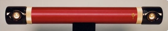

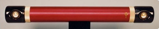

more on Cabar which is "a single unit active stereo monitor loudspeaker system" (image attached):
Watkinson's design priorities are very much like Yoshii's of Time Domain
I only wonder in what sense the Cabar is "dipole speaker"? Certainly not in a conventional meaning of the term, perhaps more like Swiss Stereolith: http://www.stereolith.ch/
best regards,
graaf

phase_accurate said:Each of the wide-range drivers that you see on the picture have a "brother" on the back.
I see - thanks for clarification
so these are "tweeters"?
are the "woofers" at the ends firing to the sides?
best!
graaf
I think you are doing these drivers injustice by calling them tweeters.
It is difficult to recognise on your picture but the narrow shiny part between the red center tube and the black end-pieces is in fact acoustically transparent. The woofers are using the ends of the red tube as "box" and their sound is emanating through this acoustically transparent part. The electronics occupy the middle part of the tube.
All in all the device looks a bit like a stylish ghetto blaster.
Regards
Charles

phase_accurate said:I think you are doing these drivers injustice by calling them tweeters.
well, exactly in order not to do them injustice I have called them " "tweeters" " with ""
"tweeters" because they are high-passed
these are Bandors, aren't they?
the "woofers" are also Bandors?
thanks for detailed description
best!
graaf
