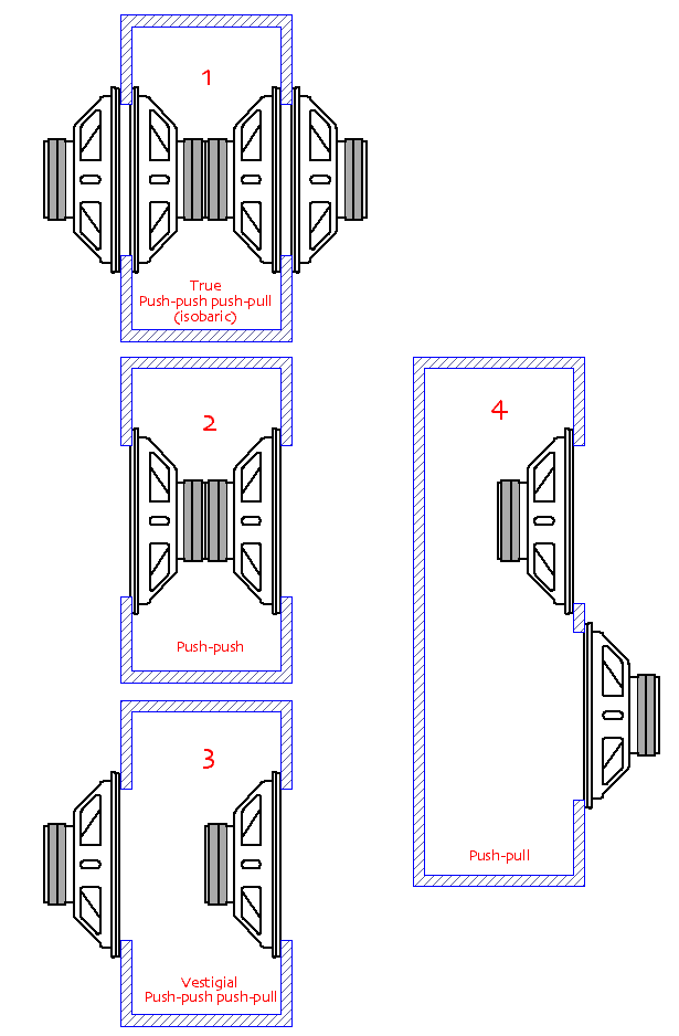

To get non-linearity cancelation you need push-pull where when one driver's cone is moving away from the motor, the other is moving towards the motor.
Referring to the attached diagram, normal push-pull is arranged as in #4.
Push-push is an arrangement where the drivers are oriented such that the newtonian motion of 1 driver is actively cancelled by another. The most effective way to achieve this is when the magnets are rigidly coupled as in #2.
#3 is an arrangement of push-pull that, if you couple the 2 drivers together mechanically with ready rod bolts or carefully placed braces, gets you most of the push-push advantage of #2. (one could mount the drivers such that they fire into a holey PVC pipe the same diameter as the driver)
#4 is the ultimate push-push push-pull. it also gives you a box that is 1/4 the size of 2, 3 & 4 (which all have the same box volume despite what you might gather from the cross-section). It also gives added isolation from waves coming back thru the cone.
In each case the drivers are wired so they all push on the boxes internal volume the same way.
2 drivers can be treated as a single driver with 2x the Vas (and 2x the Sd).
When wired in parallel, efficiency is increased by 3 dB and -- if driver by a true voltage source -- sensitivity goes up 6 dB (3 dB increase in efficiency + 3 dB due to the amp delivering 2x the power)
When wired in series, efficiency is increased by 3 dB and -- if driver by a true voltage source -- sensitivity stays the same (3 dB increase in efficiency - 3 dB due to the amp delivering half the power)
Sensitivity is a specification i'd like to see binned -- there are lots of amplifiers (tube amps of almost any ilk for instance) that do not satisfy the criteria of being a true voltage source.

rick57 said:Which do you think is a more useful to cancel, non-linearity or the newtonian motion? ... the drivers aren't that good
A little ingenuity with the box bracing and #3 will give you all of the non-linearity cancellation, and most of the newtonian motion cancellation.
While if the drivers are good, eg Peerless CSX (I also have), better to cancel the newtonian motion (push-push)?
Yes. And gain the WAF. When i talked with Nick (Llambda) about these concepts he said that if using his drivers, there would be next to no gain doing push-pull.
And when you have 4 drivers (i have a set of 4 from a cancelled plan):
#1 (push-push push-pull) - what is the effective Vas and effects on dB & ohms?
I tend to like pairs of woofers so i would look at 2 push-push woofers, but when you have 4 drivers in isobarik configuration, except for the doubling of the volume inside the box that they take up, you treat them as a single driver. Vas, Qt, Fs is all the same. Efficiency goes up 3 dB, and assuming series/parallel we end up with a sensitivity increase of 3 dB.
