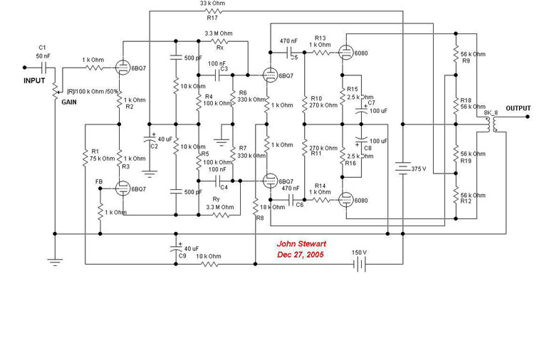

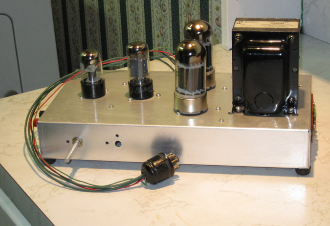

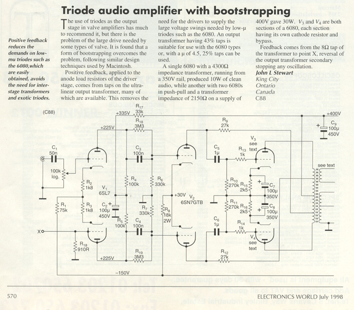

The thread appears to be quite dated but recently resurrected. I read in the original posts the concern with driving PP 45s, the rather high voltage. Attached is how I did it almost 20 years ago for PP 6AS7/6080s, a very much more difficult requirement.
A simple change allows boot strapping without the UL OPT.

:) I had seen quite a few circuits meant to drive the 6AS7G/6080 family. All looked to be of the 'brute force' variety. Looked like bootstrapping would be a very clean solution to the problem. It is.
It is surprising this very obvious circuit would not have been tried sooner. But after I posted it almost 20 years ago no one came back with evidence of its earlier application.

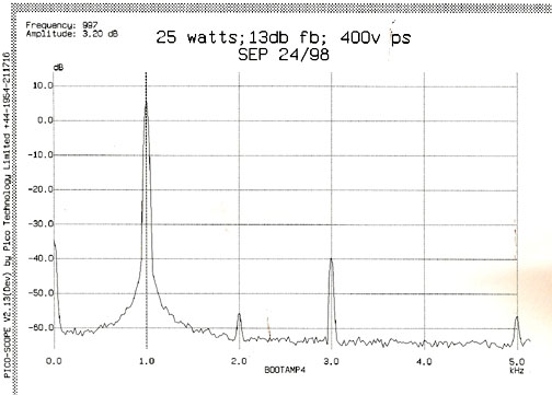

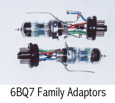

In a later project I tried the 6BQ7 family as replacements for the very expensive 6SL7 & 6SN7. The performance was very impressive, makes one wonder why they are ignored. So I tried them on this one as well, again the results were good. All backed up with careful measurements of IMD & THD.
There were complete articles on both these & several others published in Glass Audio & AudioXpress. I have them with added info in PDFs. Just let me know, I can send them.
Cheers to all, John L Stewart P.Eng
