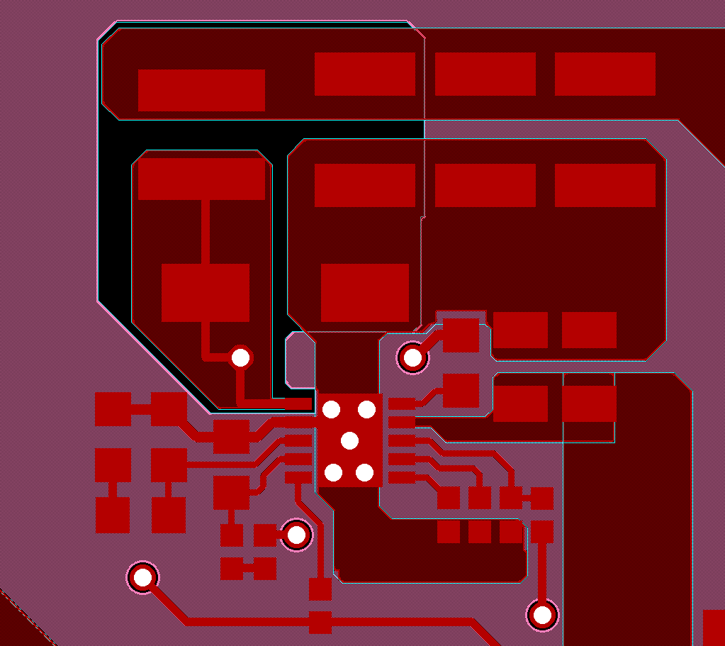

I played around a bit with that, and managed to get the '3680 ground on one layer. The other layouts will be a bit tougher to do, especially the '3652. Also put a better ground on the '3103.I'll dig the data sheets out.
Initial comments would be to try and get all the related copper especialy the switching ground on one layer.
Just doing a LTC3789 12V 5+amp layout now, with a cascaded 5V TPS5424 about 2A.
But for all layouts, there's plenty of ground pour on the top, lots of vias connecting top and bottom ground, and the bottom ground plane has very few cuts in it. So I think I'm good, at least for "ground to ground" inductance and avoiding magnetic loops.

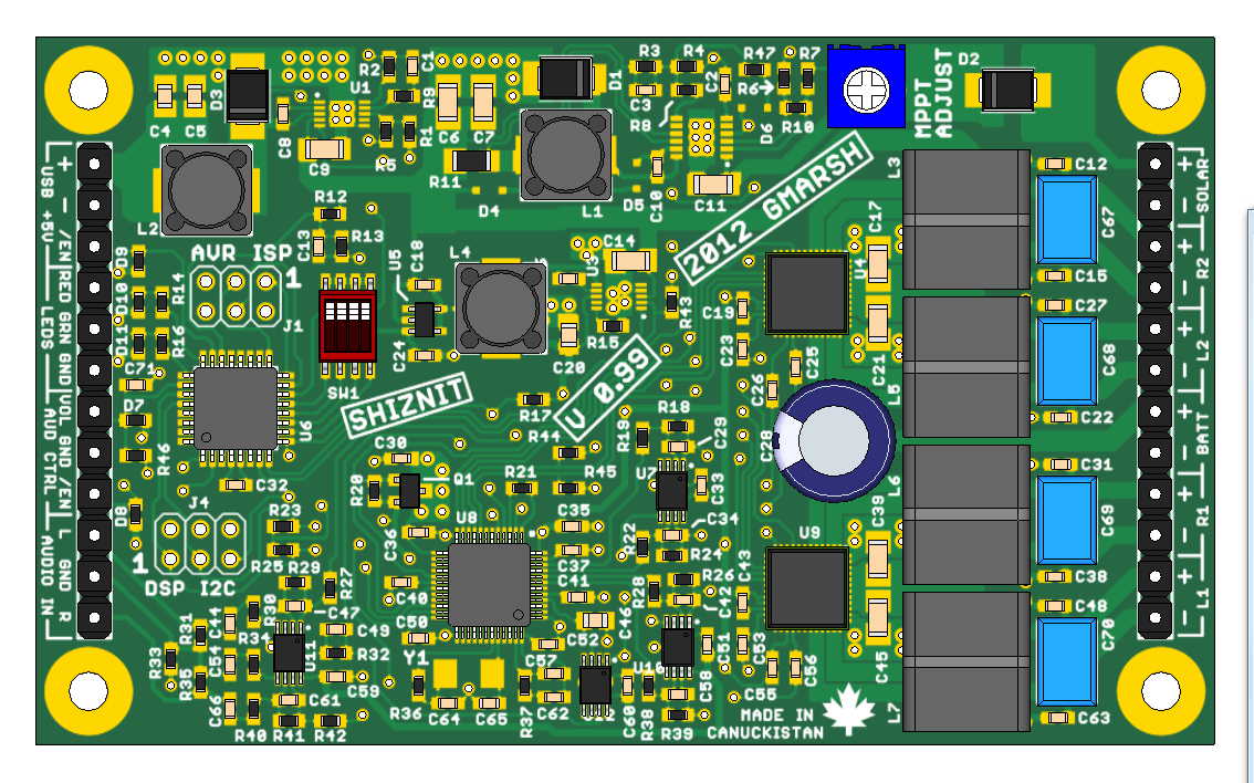

I was playing around with a Eagle plugin that generates a Sketchup model of the board, which is pretty slick. The board fits perfectly in a Hammond 1590N1 box, with a fraction of a mm from the sides and screw risers of the box. However, there's only about 8mm from the wire entry of the terminal block and the long side of the box. You'll basically need pliers or tweezers to stuff wires into the terminal block when you're wiring the thing up, unless I go with a 2 piece block.

A bit better explanation of what I meant, with some basic pictures to help illustrate. Plenty more examples of SMPS design as I do an awful lot of them and have worked closely with National Semi, Ti and Linears application engineers and others to get my layouts as near as perfect as I can and reduce any EMC problems. As stated I have just finished a LTC3789 design and spent monday with a Linear engineer going through every aspect of my layout.
Depending on the controller, the following notes are to help minimise the EMC effect of any switchers on the rest of the layout. With reference to the attached picture that help illustrate the points.
The GND that is part of the switching loops should be isolated on the same layer as the switcher components and joined to the main system ground at one point only by several vias, usually the thermal pad of the controller IC. (In the attached pictures, the vias are either side of the thermal PAD, this was a the request of production who had some worries over solderbility, newer issues of this supply have all vias within the thermal pad). This limits the high di/dt currents from the main PCB ground plane(s).
Again depending on the controller, it is recommended in most cases to avoid ANY copper under any of the switching nodes copper and the inductor. This avoids capacitive coupling of the switching noise to any voltage plane or signal. This is not often discussed in detail in data sheets and app notes, but is considered best practice when doing SMPS's. There are some exceptions, but the majority of layouts benefit from this practice.
Feedback, keep the feed back resistors as close to the device as possible and the traces between these resistor to the controller IC as short as possible, these traces and resistors should be one of the first things placed during layout.
Any current monitoring traces should be routed as true thevorin traces and the lengths of iether leg kept as near as possible the same length.

Thanks for the info Marc, that's a pretty nice layout. I'll put a bit more work into the switcher layout and see if I can put together something better.

Layout finished again! (ha)
Spent an hour toying with EagleUp/Sketchup, here's a render of what the final board should look like. Created a few parts for fun, couldn't be bothered to do all of them.
Tallest part on the board is the capacitor, which is 12.5mm.
In the process right now of going through passive component values, making sure everything is kosher and trying to minimize the number of unique values. I'll post the Eagle files when I'm done that.

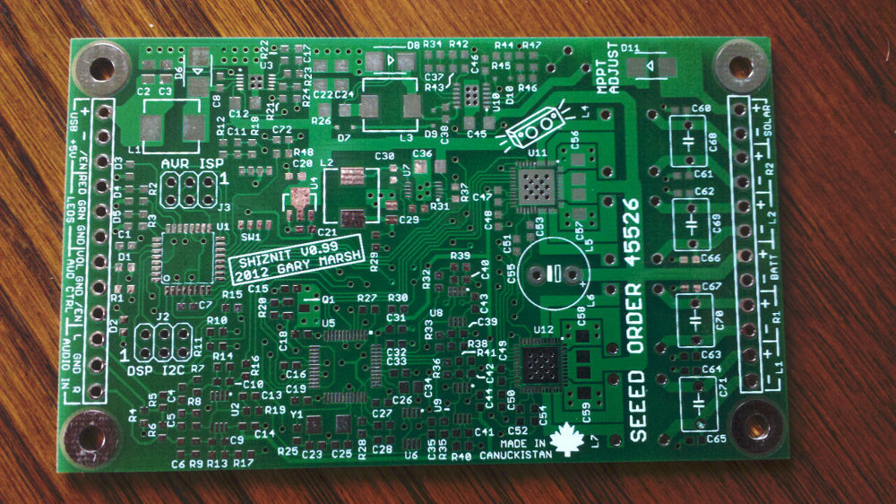

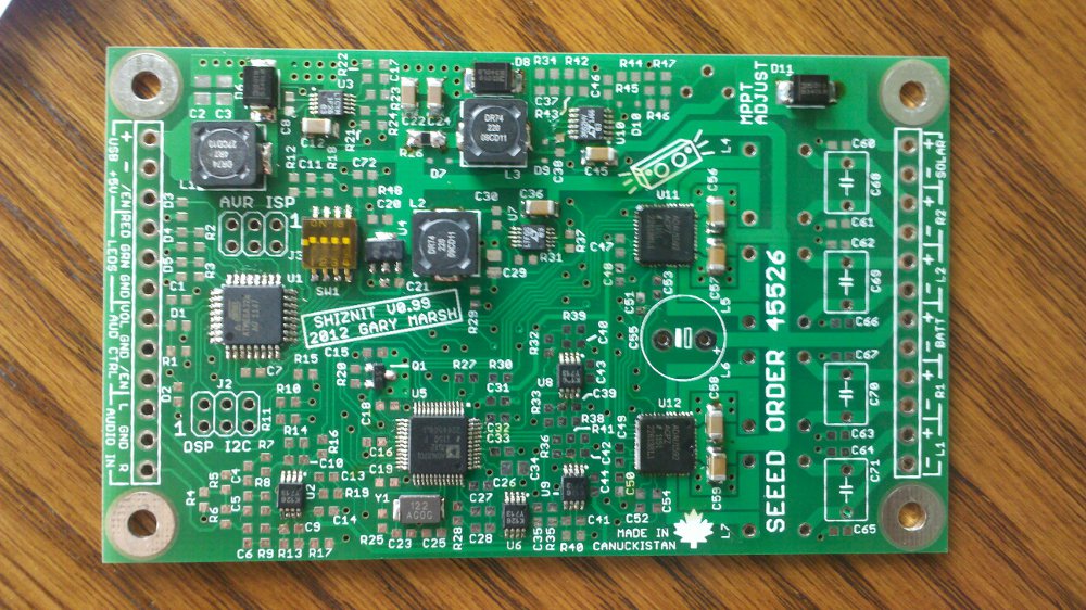

Olimex took too long, sent me a bad PO and then went on vacation... so I ordered from Seeed Studio's "Fusion" service instead. Getting 10 boards made for about the same price I was getting 2 Olimex boards for.
Crossing my fingers that the prototype boards work, so I have boards I can populate/sell.
