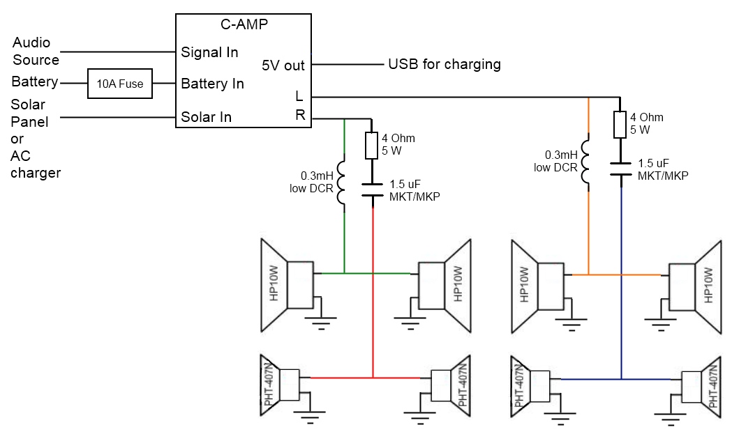

I'm going to be the biggest noob here (sorry) and ask how one would go about wiring one of these up for the Boominator (Using 4x HP-10W and 4x PHT-407N (Or if its easier, MPT-001 / KSN1001A)).
I understand enough about it to wire up the solar, battery, inputs, etc. I assume a passive crossover is needed, but this is where I have always come undone... Is a passive crossover as simple as a resister on the positive of each woofer/tweeter? Or is it more involved.
I have searched, so if I have missed something, a point in the right direction would be much appreciated!
I built a speaker box in the passed loosely based on the boominator, but I am now diving into the full setup, using every recommendation from the experts that I can!
Thanks both Saturnus and gmarsh btw, for such great work!
Edit, OK so after continued search, I found this diagram, which is perfect!
Ordering my cAMP soon, I do have some further questions about it though, if that's ok.
Most Solar controllers suffer from an issue, when the light is too low to charge the battery, they tend to draw a bit of power from the battery. I think you touched on this saying idle power is very low. When off (and with the amp switched off using the control terminals) is it only the LED flashing every 5s that draws power? I assume the consumption would be next to NIL if this is the case, otherwise, since I'm assuming the micro controller still needs to run, what's the general draw at night, everything off.
Also, I may have missed this part, your USB output seems to have all 4 pins accounted for, does this mean you can also play music via the USB connection from smart devices (iPhones in particular), or is this just to help aid in charging in some way?
And finally, I will have a RPi (original, 0.09a @12v), a small rougher (0.03a @12v), as well as a Bluetooth audio adaptor, by default these will all be off, but to make sure these are powered by solar first, battery second, and since the board doesn't (as far as I am aware) have a load output, would it be best to have them connected to the battery output on the card, or is it best to connect directly to the battery (since it's such a low amperage, shouldn't overload the battery).
Thanks in advance!

The cAMP pulls around 1mA on average in standby mode, even accounting for the LED blinking. With a 10aH battery that's 10,000 hours or well over a year of standby time, chances are the battery's own self discharge current is worse than the amp standby current.
The USB output has a dedicated charging port control chip on it (TI TPS251x) which allows for seamless charging of both Android and Apple devices. I'm sure USB playback would be a nice feature, but it would involve putting down an XMOS or similar chipset and getting a MFI license, which would blow both the power and economic budgets.
I'm not providing a switched load output or anything, if you're running other things off the battery it's up to you to ensure they don't run down the battery.
The +5V USB output switching regulator on the card is good for 2.5 amps, I've derated it to 1A (and configured the DCP controller to advertise 1A charge current) knowing that people are gonna mount the card with poor ventilation in a black painted Boominator and probably bitch and complain when it doesn't charge their 2.1A iPad To power your Bluetooth adapter and probably even the RPi, you can probably just power it straight off the USB output provided the current draw is reasonable. Only catch is the +5V USB output on the cAMP runs all the time unless the battery is low, so you'll have to add a power switch to cut power to your 5V stuff.

There's no "controlled battery output" anywhere on the cAMP card. The TPA3118 chip, the +5V USB regulator, a +3.3V LDO supplying the microcontroller, etc... are fed directly off the battery voltage. When the amplifier's switched off, the TPA chip is put into shutdown mode, which greatly reduces its quiescent current. When the battery goes critically low, the +5V USB regulator is shut off as well and quiescent current is then even lower.
Connect all your +12V loads to the battery, not the solar panel side. With a solar panel present and sun shining on it, the solar panel voltage is regulated to about 17V by the MPPT controller.
