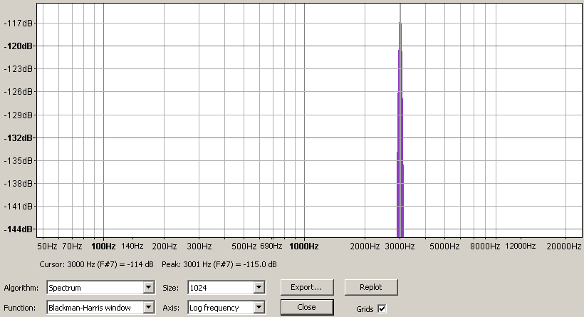

In case of 1kHz, and Audacity's 16k FFT limit, bin width is more than sufficient for resolving distortion limits of TLE2072 spec, and virtually any loudspeaker played at any level.

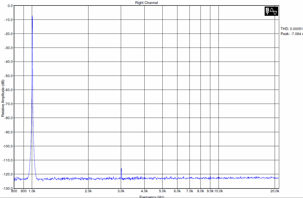

Sorry, sounds like empty phrases to me. Would you show any measurement like this made with Audacity?
Pavel,
Many surgeons prefer stone knives.
I'm not advocating Audacity as tool of choice, but it is remarkably powerful, open source, and quite workable.
Here is 1kHz 0dBFS with 3khz -115dB with 1024 bin FFT:

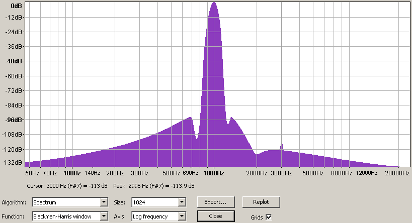

A throwback to when digital tools were scarce, and very expensive. Since 1kHz is known stimulus a notch filter is applied, available as Audacity effect, and result becomes:
The notch filter is narrow and clean enough for resolving 2kHz harmonic too.

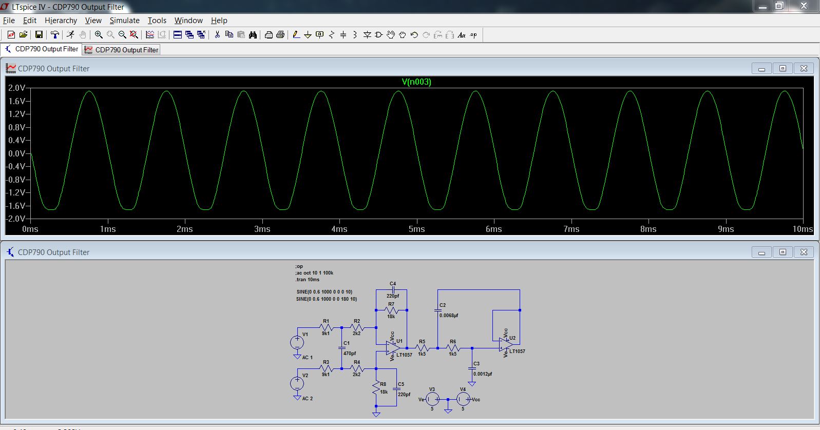

This is an I/V and more importantly filter stage. I haven't simulated it, but my guess would be that it might be a little hard on the opamp's output stage. Which could explain why the much beefier 5532 did just fine while the TLE2072 (with load immunity being about a factor of 4 worse) struggled. Filter circuits may also exhibit higher internal levels. I guess I'll just sim the thing tomorrow.

Try this. I find that opamp sims aren't always reliable but must admit that here and using a FET opamp... well the result is obvious. The effect on a scope wasn't quite this bad and no tendency to hard clipping. And this is at way below the -/+2.8 volts pk/pk that 0db gives.

Seems the problem simply is input common-mode range. The TLE2072 is given with +5/-1.9 V typical on a +/-5 V supply, and there's a unity gain buffer in there that has to swing down to -2.83 V, as do its inputs. Which would correlate with distortion setting in a little under the -3 dBFS mark. The NJM5532 typically does +/- 3 V under the same conditions, hence no problems. (Got any mean >0 dBFS test signals like that fs/4, 90° sine? That ought to be it.)
For kicks, one could try a TL072... Inversion time! :D
Clearly a case of "plug'n'pray". Those are the perils of low supply voltages and non-RRIO opamps.
