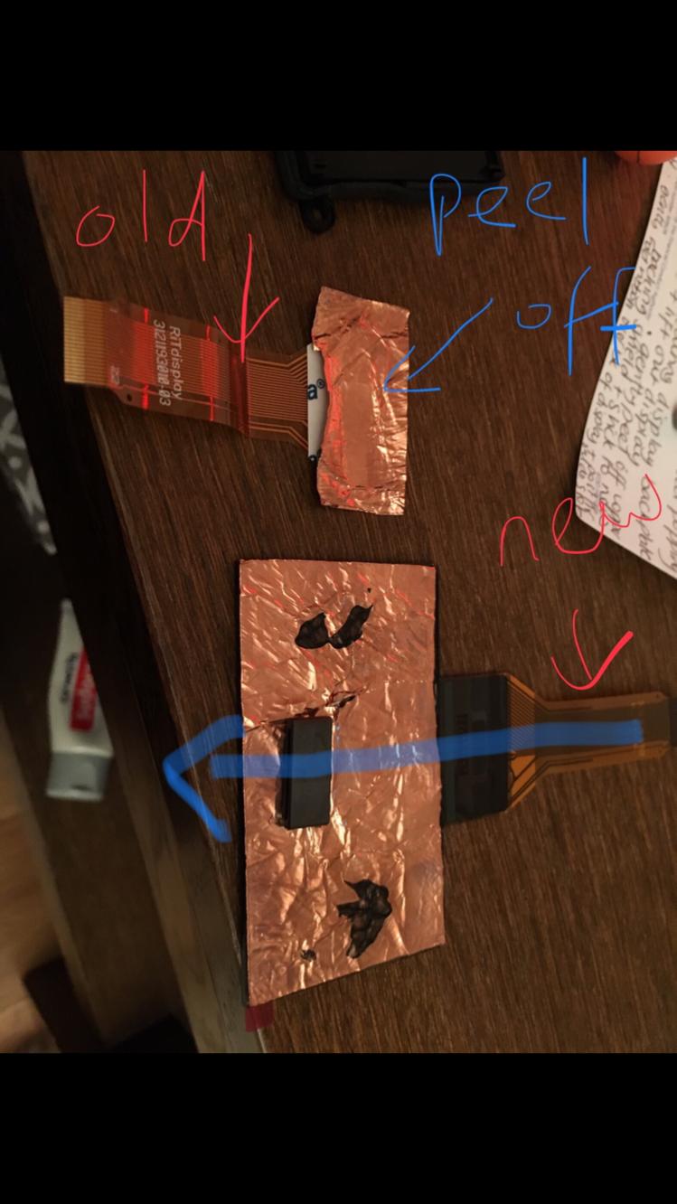

I followed the step by step instructions from the original thread by OxfordDownings on p12. It is fiddly, especially the peeling of the copper backing part! But I did it - and if I can so can anyone else as long as you’re patient and take your time. It took me about 30 mins taking my time.
I have taken photos to show the steps visually incase it helps someone who is scared to attempt it. Have attached just 2 pics here 1. Note the numbers 1 and 22 in the old ribbon for orientation. The new ribbon had same numbers in same place and the 2 black clips that need to be pushed up to release the ribbon. 2. The copper backing that needs peeling off the old screen and attaching to the new. This bit needs to be done v gently! I hope pics help.

Just to add re the 2 photos above: the number 1 in first pic is not visible in that pic. (I have other pics that show the 1 on the other side of the ribbon (side of the upgoing red arrow). The downgoing arrow is showing the black clips. The 2nd pic shows the new screen with the copper backing already put on and the old screen’s ribbon removed from old screen (which also has another bit of copper backing which I also peeled off and used to stick down the folded new ribbon down onto the copper backing of the new screen in the direction of the blue arrow. The ribbon then slots through the little slot at the back you can see.
I have other pics if anyone needs for the steps but these 2 are the tricky bits.
