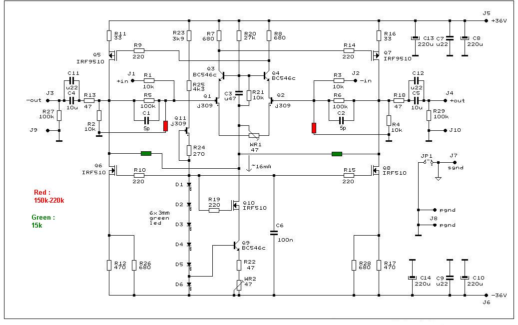

Anyone with one of these and an osilloscope.
Can you please put scope across output terminals and record your results.
My two have 50mV 20MHz sine wave imposed on output with inputs short circuit.
All components are the correct values, everything is inserted correctly, component matching was by ZenMod himself. Two of them would tend to rule out component failure. THEY WORK but they oscillate horribly.
in case that you're going to alter gain , you need to increase C1 and C2 in same amount you decrease R5 and R6 ; their F0 needs to be in 250-300KHz
for decreasing gain is wise to somewhat increase R1 and R3 ( say to 22-27K) and then to decrease R5 and R6 to needed value
I'm not worried about frequency response at the moment, I'm just vtrying to stop these things oscillating.
A perfect 20MHz oscillator.
Give me a break here, you designed the things and they dont work.
I'm not a designer.
One is exactly as you designed 10 X gain - It oscillates at 20MHz
One has be reduced to 2.7X gain = It oscillates at 20MHz
There are no exrernal influences - WHAT IS WRONG.
Everything is as according to your BOM.
It makes no odds whether it it is driven by Shuntky, simple regulator or no regulator, Pumpkin is a simple oscillator.
