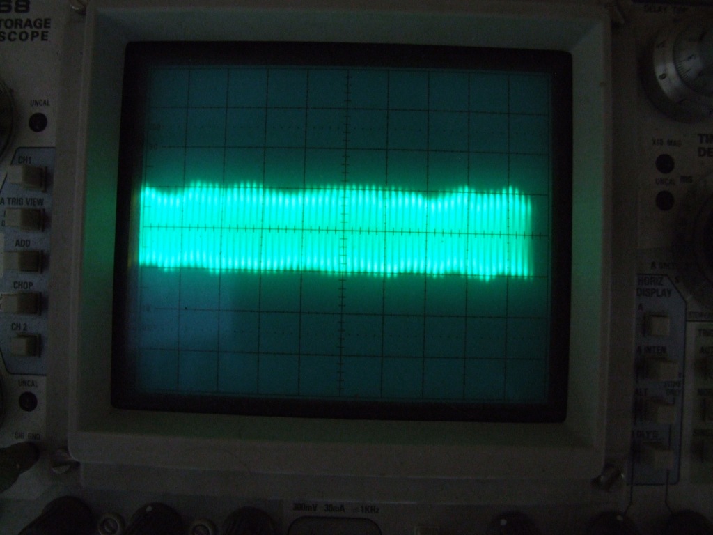

Well I finally got one of the Shuntkys out of the box and put it to the test.
The results aren't as good as I expected.
With the Shuntky miles away from any electrical equipment, including its transformer, I get a 20mV 20MHz ripple on the outputs.
Is this normal ?
Is this normal ?

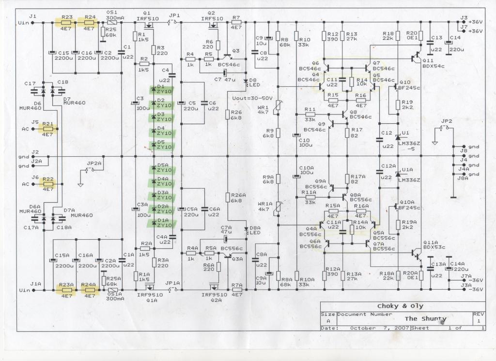

Those not familiar with the Shuntky, I have attached the Schematic.
I decided to measure the 100Hz (UK 50Hz supply) ripple at the output of the CRCRC filter, it was huge, almost 100mV Pk-Pk.
Simplest thing to do was to remove the two fuses OS1 and OS1A. With the fuses removed the CRCRC circuit is as close to silent as I can measure.
YES, the Shuntky is supposed to pull current, but not to the extent where the input supply is compromised.
