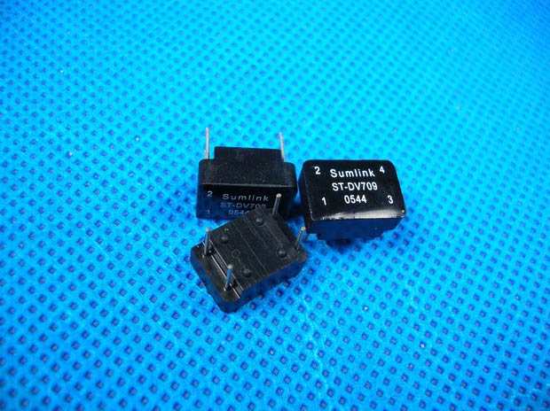

i have diy nos dac with CS8412 + 4x TDA1541, now i want to change cs8412 with cs8414.
also i want to know more about spdif input using pulse transformer, i read on datasheet that it is recommended to use pulse transformer.
can i use PE-65612 or ST-DV709 for input ?
here is the original schematic
for what i know, if i use cs8414 i should change the PLL filter with (wildmonkeysect tweak)
"CS8414 loop filter 3300pF between filter and Agnd, 220nF and 470R in series together parallelled to the 3300pF cap"
heres what i have in mind
if i do something wrong please enlighten me..
anyhelp would be appreciated.
thanks
