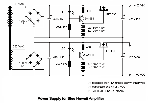

For the regulation option I was delighted to find a nice and simple schematic from Headwize by Kevin Gilmore, see attachement. I can't understand how this can use a 450V capacitor after the bridge, can you?
Math=375 +/-10% mains variation * RMS value is 375 x 1,1 x 1.414 = 583V aka a 630 capacitor should be used!
One thread I read that hybrid topology gives different noise spectrum in the positive and negative rectifier cycle? I think it was Geek talking about this...

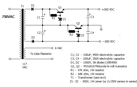

Also in another schematic by Kevin (see next posting for attachement) he uses a full wave topology instead. Except for diode ratings and such as discribed in textbooks, this should be exactly the same?
Thanks...

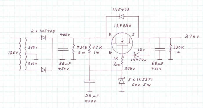

The regulator can be improved a lot, I guess, most likely with a 2 transistor version, like attached.
Also I think I'm being a bit paranoid about using a ss/tube hybrid rectifier and then a SS psu regulator, this is maybe overkill. Point is I just want to check out and build the different topologies.

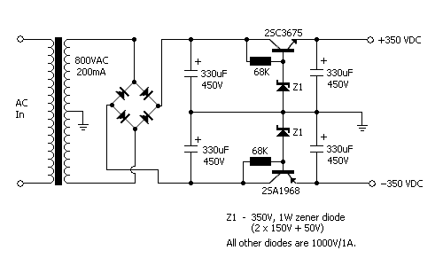

Also another question that I have regarding seperate mains transformers for positive and negative rails as in attachement... Are there any pro's regarding this?

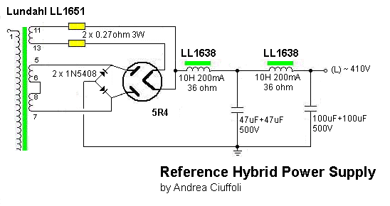

Here's an hybrid example from AudioDesignGuide, this will give a slow start up of HT. So my plan is to not use the 2 PS chokes, 4uF caps instead of 47uF and us a regulator in place of the second choke. Does this look alright, any comments?
