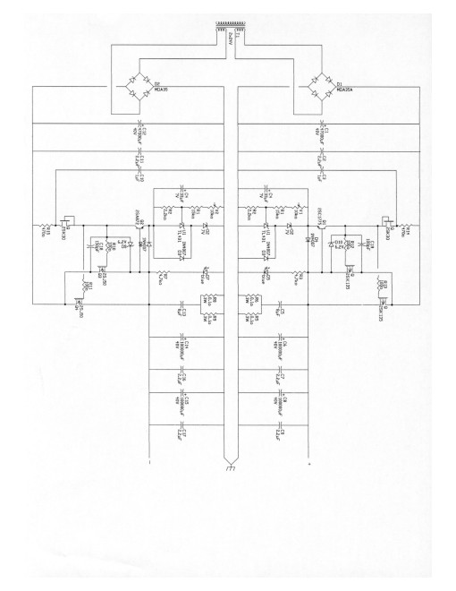

Thank you guys for your interesting contribution.
Please aplogize the late reply, but I'm traveling a lot, which hinder to be frequently online for the hobbies.
I have attached an actualized scheme of Pierre Johannet's proposal puplished in the issue 19/1992 of the French journal L'Audiophile for a hybrid PSU, which I successfully use at my 50W Kaneda power amp.
This one I intend to try with my Hiraga 30W, in comparison with my actually used passive PSU version with a total C of 1.4 F.
May I have your comments and input please.
I will keep you updated with the results (subjective comparison) on my front loaded ORIS 150 hornspeaker of BD-Design/NL.
Regards
Gerd

Sorry I'didn't think so far.
Attached please find the scheme as jpg-file.
Gerd
