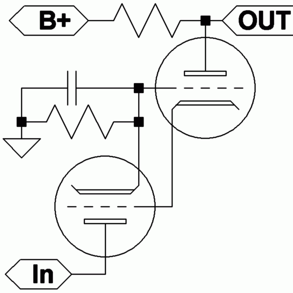

Originally #10 posted by kenpeter
Incomplete OT schematic without part values ...
I'm not sure which rail you prefer common to
power noise in this situation. Depends what
are you intending to drive in the next stage?
What was the trouble with Mu>1 and a resistive
divider??
Nutz... I inverted twice.... Thats not helpful!
If I make the inverted triode behave as a follower
then overall Mu does not revert to 1 as intended.
I don't see an easy way to fix this.

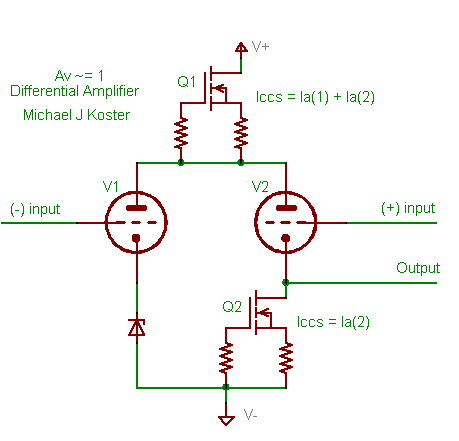

"I think the attachments from this thread
are interesting for you."
Very interesting. The signal path outlined in red helps a lot

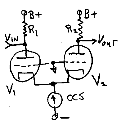

#21
Don, I think I follow and it looks like the same idea. No grid current... Here's my doodle along the same lines. I was thinking similar triodes but the slight mismatch is interesting. Or I may be off in the weeds
Michael

"Here's my doodle along the same lines. I was thinking similar triodes but the slight mismatch is interesting." Ken
Looks good to me. Maybe want to upgrade those depletion mode CCS's to cascode ones for lower capacitance effects. Obviously this approach has a close parallel with Darius's fourth topology or triode transformer mode. But two tubes to get unity gain.....? (OK, I know, op. amps have dozens of transistors, and people still use them for unity gain at times.)

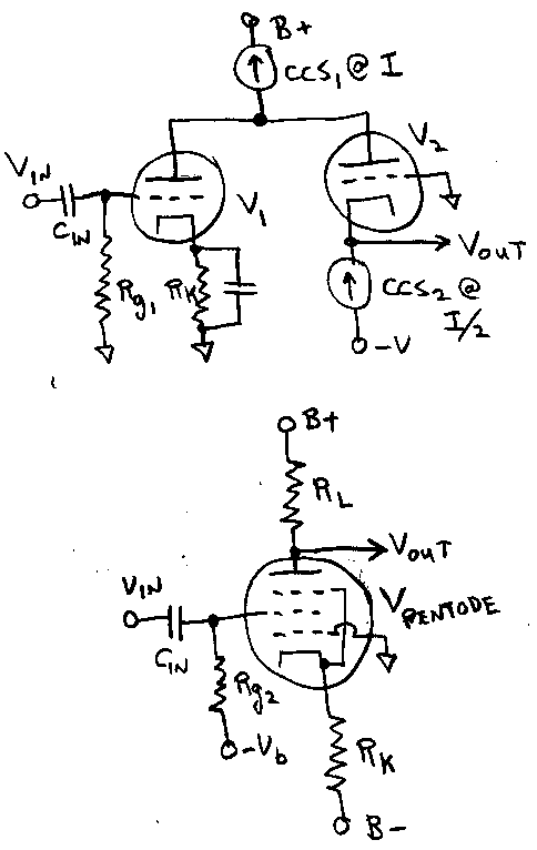

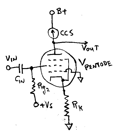

The pentode scheme (g2 driven) still seems the easiest way so far, to me. Or the beam deflector tube scheme. Wonder what Darius will come up with now for his preamp.

The triode has feedback between all three terminals. Even the plate
resistor presents a negative feedback. It is hard to call any triode
circuit (except perhaps the lower triode of a cascode) one without
negative feedback.
Oldeurope will have to define which modes of negative feedback are
acceptable, if we are to understand the rules of his game. So far he
has given us only intrinsic voltage feedback from the plate (resistor)
to work with. I take nothing else for granted.

You could ground that biased and bypassed node
and it would still "work". But then you have to pull
the lower plate negative to shut off grid conduction.
I thought this way of bias might be convenient???
If bias works at all here, and I'm not entirely sure...
Way outside the box, even for me.

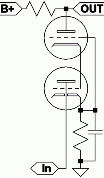

Same circuit, different drawing... New symbol.
Was giving me a headache trying to wrap my
mind around the abomination I had created.
I needed a different way to draw an inverted
triode. One that would convey the plate as the
control element, and the grid as the anode.

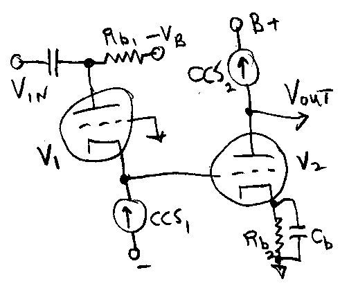

Ken, post #29 schematic:
Whoa! Is this thing still conducting normal electrons? OK, looks interesting, attenuate first with inverted triode (neg. plate input, hi Z input, pos. grid output), then amplify with grounded grid. This setup will definitely drive the serviceguy nuts someday. Makes sense to attenuate first with the inverted triode though with its grid output, but it will have trouble getting much current out for the subsequent grounded grid stage cathode. Assuming 1/Mu1 for the 1st stage, I think the 2nd gives Mu2-1 gain (the cathode variation eats 1 Mu from the output)
To address the current disparity, maybe should ground the grid of the 1st tube, but still use negative plate bias for input on it's plate. Then take it's non-inverted cathode signal as the output to the grid of a 2nd conventional grounded cathode stage. Then there's no loading on the weak 1st stage. The second stage provides normal Mu gain and inversion. 1st stage giving 1/Mu+1 and 2nd stage giving Mu gain.

Huh, ya know, it looks like that last circuit would work just fine with conventional B+ on the V1 plate input too. With a CCS in the cathode, the plate Z goes way up, even in conventional (plate as plate) mode. So that Rb1 resistor could be a high value going to B+ instead of -Vb.

The post #33 schematic gave me an idea for improving the screen driven pentode scheme. With constant current thru the tube, the screen current should be near constant, so the screen should have relatively high input Z. Total gain would be approx. 1/Mu_screen times Mu_plate. Since this will be a bit more than unity, the cathode resistor Rk can be used to degenrate gain a little further till unity gain is reached.

#29 #32
Hi kenpeter,
I tested the arrangement in post #32.
There are two mayor problems.
- First the gain of the inverted tube µ'< 1/µ .
See post #12.
- Second, the inverted mode triode needs a special construction
to get low distortion and a reliable value of µ'.
Kind regards,
Darius
