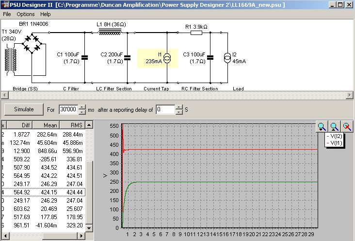

But then I looked at his power supply. His choice of a KBU6K looked a bit on the cheep side, and I immediately thought that a hexfred would be in order. And schotty diodes in the LT would also be a must.
But then I thought, what about valve rectification? Ok, the LL1669A power transformer may no longer be a good choice. I'm not sure if it has a tap. I have never done a valve rectification circuit, although I have repaired more than a few.
So a different (perhaps specially wound) power transformer may be necessary. And the current draw (including from the rectifier itself) would have to be considered.

There's probably no easy prefabricated solution. Duncan's PSUD is a great simulation program for power supplies; a little tinkering and you're done. I would strongly suggest the use of chokes and motor-run caps for best performance. The ps is very audible in se amps.

The lack of CT is not a big deal. A hybrid bridge with SS diodes forming the path to ground in combination with vacuum diodes works well. What you do have to worry about is the greater forward drop in vacuum diodes. TV damper diodes have small forward drops, for vacuum devices. A bridge made from a pair of UF4007 SS diodes and a pair of 6AU4GTA dampers just might be the ticket.

I downloaded psud2 - it is really great software.
It can't simulate a hybrid bridge, but I suppose I could just build it and measure the voltage after current draw from those el34's. I will just use the solid state bridge for now.
I estimated the current draw from 4 el34's at 234mA. This power supply also feeds half of a 12AX7 and half of a 5814.

Basically I would replace the 12ax7 and 5814 portion (keeping the 0.33uf 450V coupling cap) with Allen's SEPH1x88 and SELT2 kits. The B+ for these designs call for 250V.
I'm pretty sure I can power this from the the same mains (see my attached picture). I estimated the current draw from 6 e88cc's at 45 mA per channel (half of 90mA). This brings the B+ for the End stage down a bit to about 425V in my spud2 simulation.
And I will need to source +20V for Allen's design so perhaps this isn't feesable withought a separate PSU. I'm still working this out...

But don't use a 5AR4 if you can avoid it. A hybrid bridge using TV dampers is a much better idea, as Eli says. Indeed, if you can spare the space for two separate diodes and you can provide enough heater current, TV dampers are always the best choice over other thermionic rectifiers. They're very rugged, tolerate a very high heater-cathode voltage and warm up quite slowly compared with other tubes - a really good slow start for your B+.
