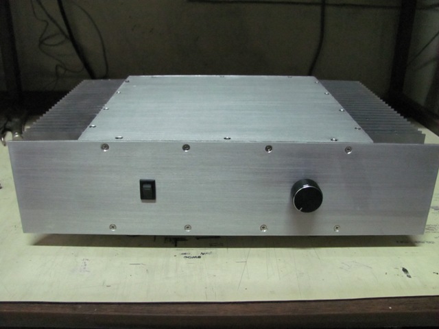

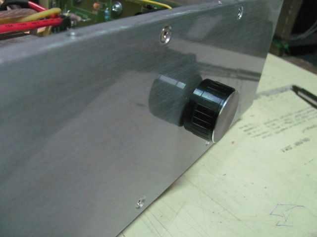

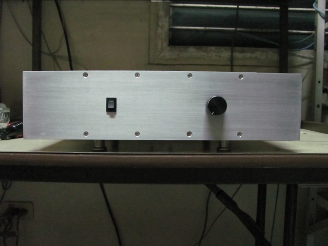

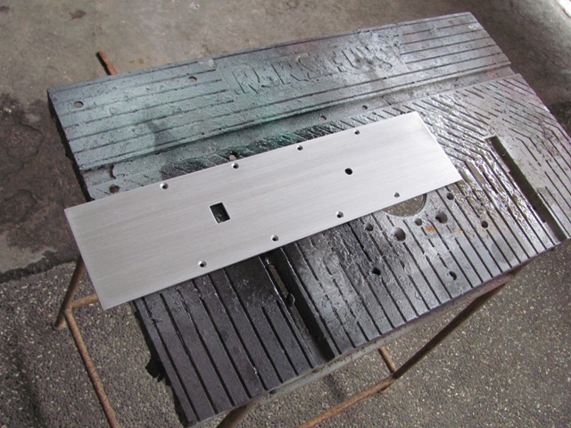

If you're going for a brushed look, I used clear coat in rattle can. I think the type was acrylic.
After wet sanding with coarse grit paper, wash with water to remove debris, wipe and air dry then spray a few coats of clear. Seems to stick well to the sanded aluminum.
