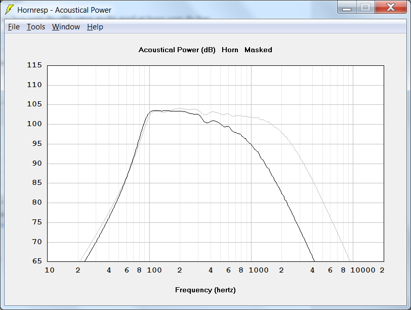

We're taking a different route. Here's a possible scenario with an upcoming driver in our horn. JBL 2220H is the black graph.
attachment.php

About the graph, when I used the JBL 2220H in a horn I did not want more midrange. It is quite screechy, if you don't set a steep crossover point at 400-500Hz. What do you want to achieve with the new driver?
I'm planning to crossover around 600 Hz, depending on driver and the sound. Need to experiment some.
I would like however, a horn that remains the sensitivity up to 800 Hz. The graph for the simulated driver keeps it it going further than what's really needed, but it does give a lot of flexibility.
Besides that, I'm hoping for an upgrade in general quality compared to JBL 2220. We'll see how it goes in a comparison.

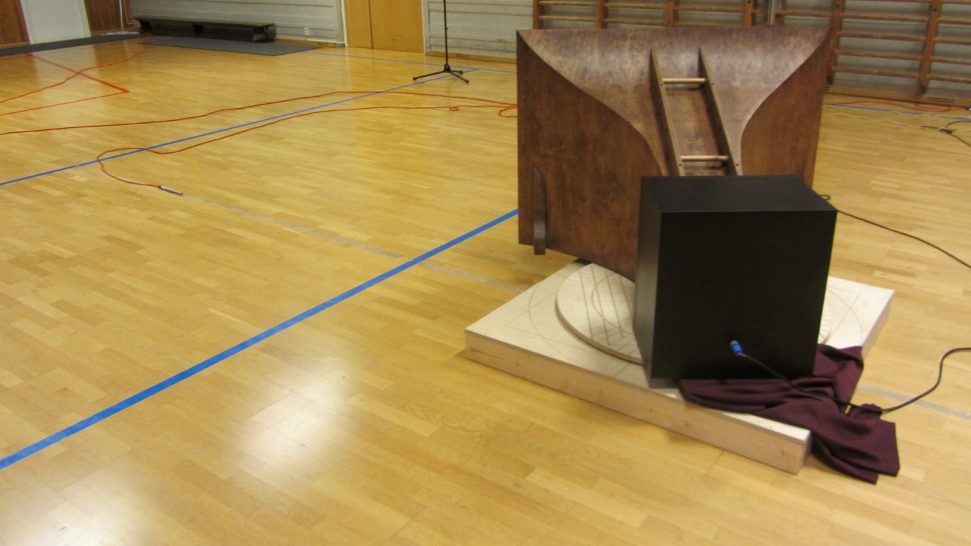

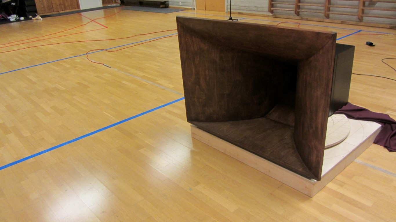

Here are some pictures of the midbass horn I had built some years ago. It measured (the polar) very well.
attachment.php
attachment.php

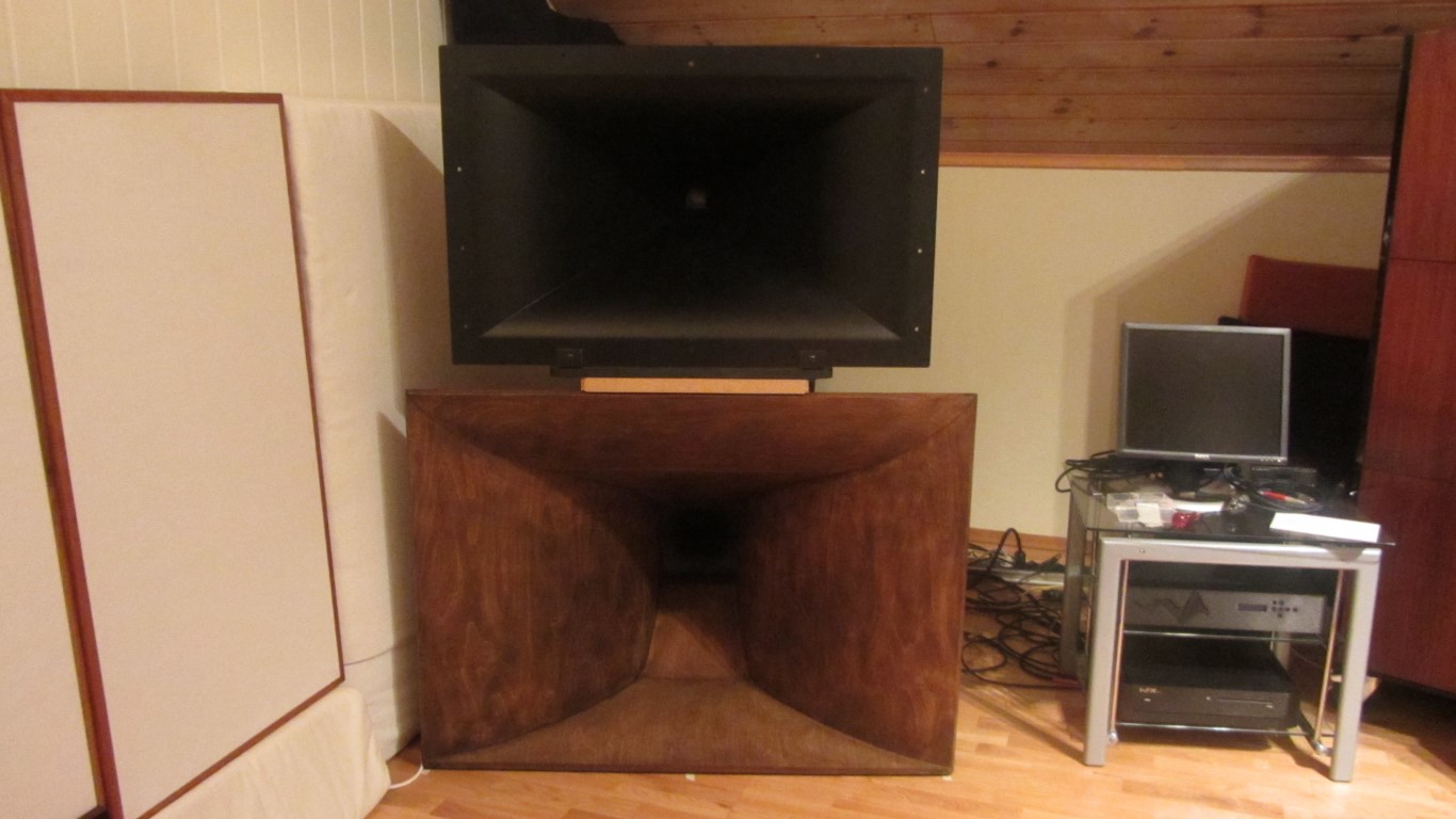

With the Klipsch K-402:
attachment.php
attachment.php
attachment.php
attachment.php
