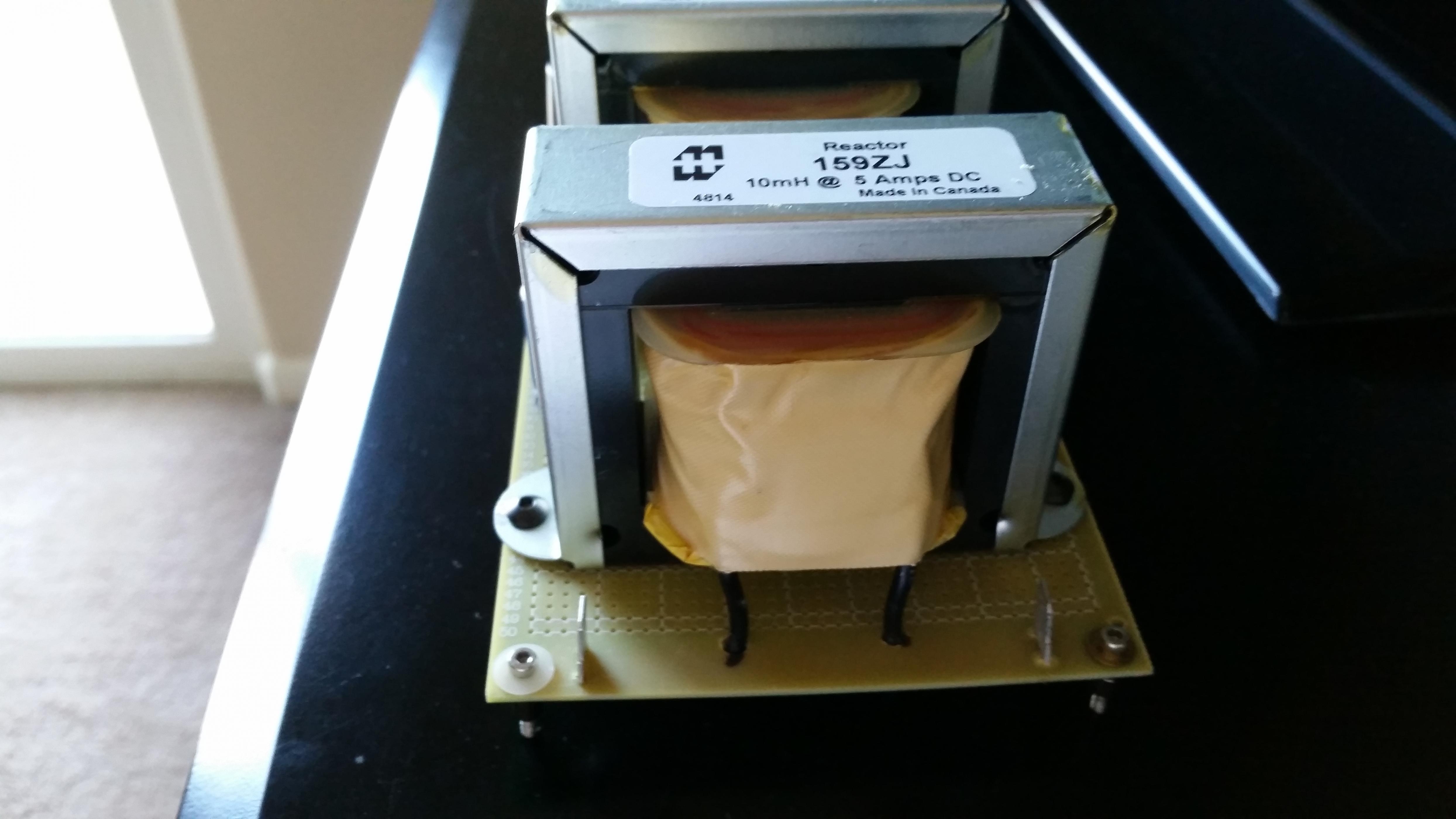

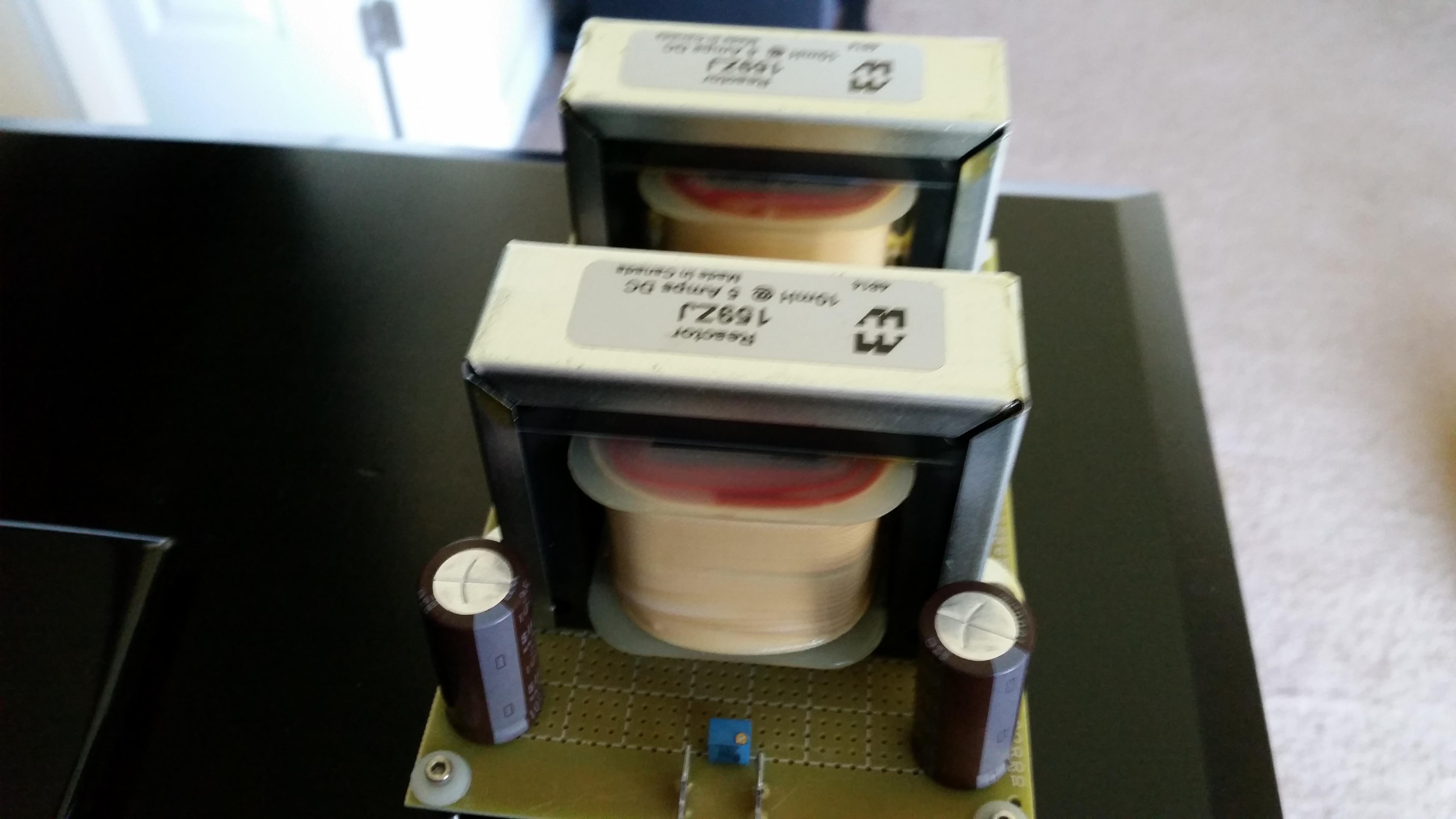

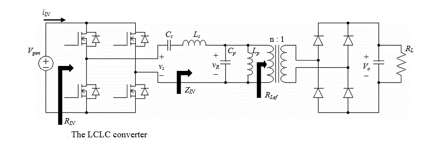

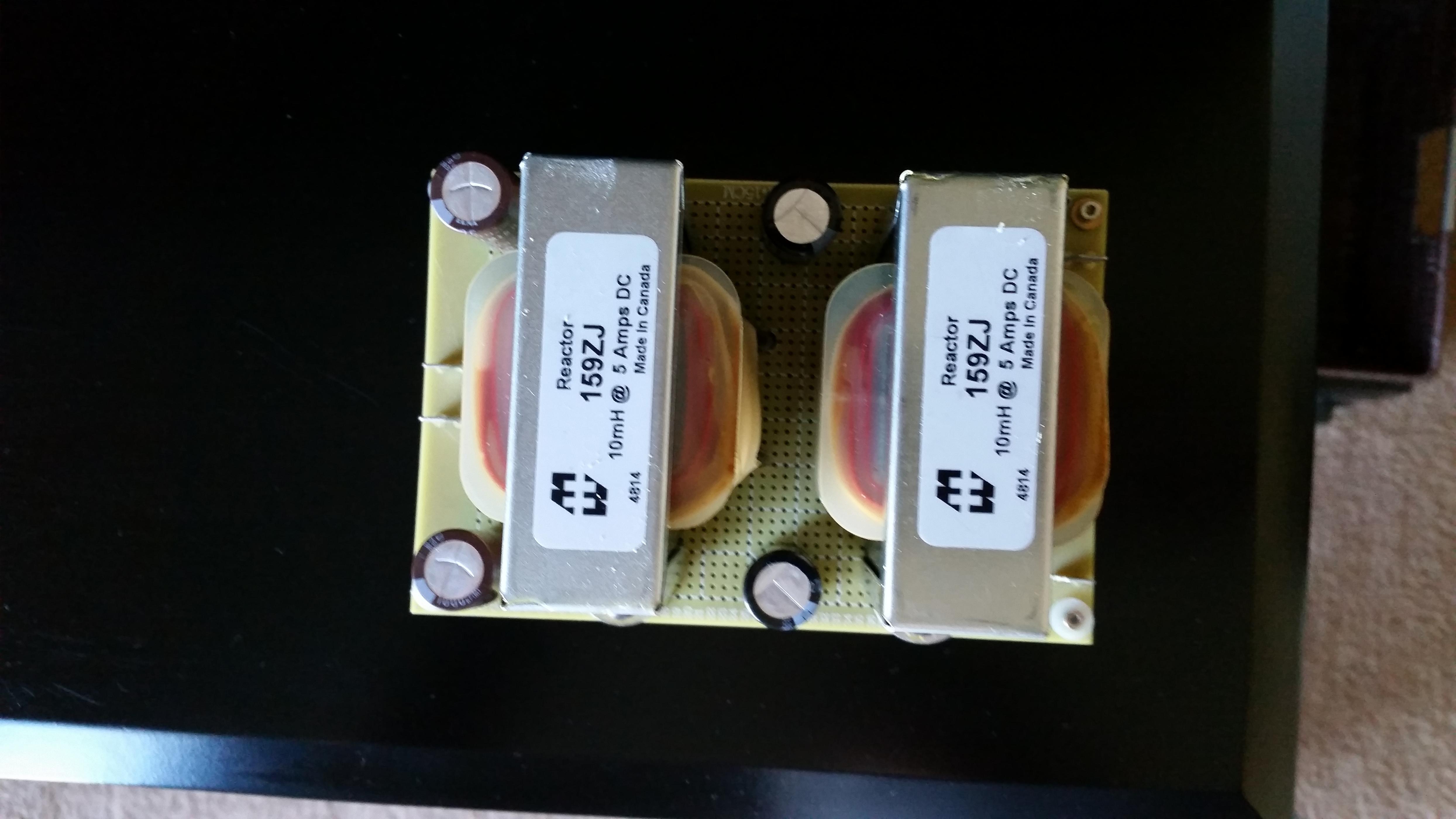

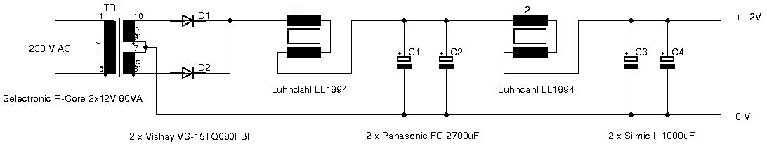

Yes, this is what I mean. I have attached a diagram as well as something I built. Without a load, I can easily and accurately adjust the output voltage with a trimpot. Once I attach it to a load, I will monitor the voltage and temperature.
I assume he meant a choke input PSU with choke smoothing too. I can't attach any other meaning to LCLC PSU.

OK. Seems a strange name for what appears to be some sort of filtered switching supply.
That is a resonant-mode switcher. The L's and C's are adjusted so that the current waveform is sinusiodal, and then the energy at switch-off is reduced compared to the hard-switching case.

I don't see a way to adjust that with a trimpot. That "LCLC" is just a 2-section choke input filter.
With that level of filtering you might be able to use SCRs for D1 and D2 and adjust the phase angle. Old-school HP bench supplies did this, but they usually had a post-regulator to clean it up. I'm assuming you are using Two LC sections to get the hum and noise down to microvolt levels without resorting to nasty "IC's" - which would make any sort of adjustable circuit self-defeating.
Thank you for your response. I have to admit that my knowledge in circuits is very basic. I am exploring this power supply because it seems simple enough and from what i've read, works well. It is silent when I test it without a load. I do not have an oscilloscope to test it to that degree.

The control boards likely require tighter voltage regulation than possible with a passive circuit like this.
How about standard linear regulated voltage supplies instead? Those are readily available, as kits or built.
With power transformers, three of these boards, 12v, 5V, and 3.3V would work. Depending on the required
currents, you may need separate power transformers with different secondary voltages for each, to reduce
power loss in the regulators. You could even keep the LC filtering on each of the voltage outputs, if desired.

Remember that each regulator's input voltage must be carefully chosen to prevent dropping out,
and also to limit excessive power dissipation in the regulator. There may be a single commercial
line operated supply available with all 3 voltages and adequate current if you look.
