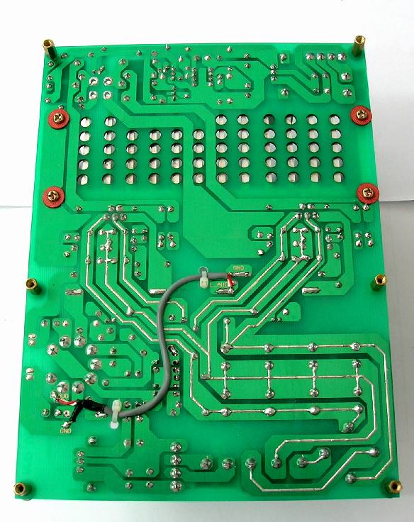

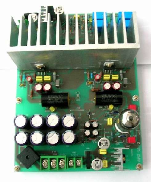

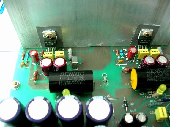

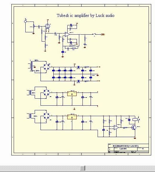

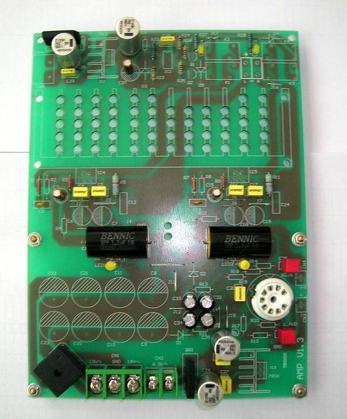

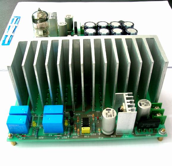

I have a project using tube 6922EH(OR ECC88)as input buffer,
LM1875 as power output IC..I had finished the engineering working sample. You can get more information in AMP Chip ......
Now i am going to make a update version of the PCB, who is interesting in this project? I think the price of all the materials in the PCB will be controlled under 40$ including the tube,ic,and heating.......
Hope more froends will join in this project....
about the power supply
About the power supply:
20V~-----0V------20V~ 3A is suggested for LM1875.....(120W)
18V~-----0V------18V~ 3A can also be used in this case.
12V~ 0.5A is for the relay part. (6W)
8V~-----9V~ 1.0A is for the "lamp" inside the tube.(8W---9W)
So, the power of the transformer shall be around 150W in this case.
