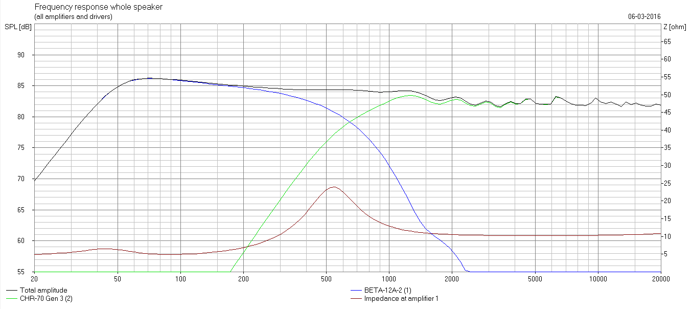

As of now i have done simulations based on the T/S parameters (using BoxSim) utilising the Eminence Delta 12A-2 and the MarkAudio CHR-70.3. The simulation results look like this;
Frequency response:
attachment.php
I think the frequency response looks good, i know the efficiency isn't skyhigh. Will the impendance peak around 500Hz be a problem?

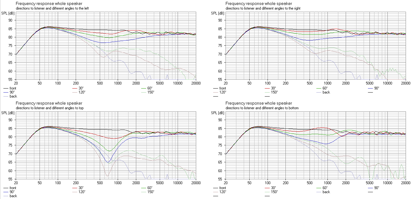

Off-Axis Frequency Response:
attachment.php
I think that the horizontal off-axis response is acceptable. But the vertical response isn't that nice looking. How important is the vertical off-axis responce? Is the dips in reponse around 700Hz a consequence of the crossover topology? Any ideas to how to fill the dips around 700Hz? Will physical time-alignment of the drivers help regarding the vertical off-axis response?

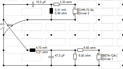

Crossover Design:
attachment.php
Critique?
