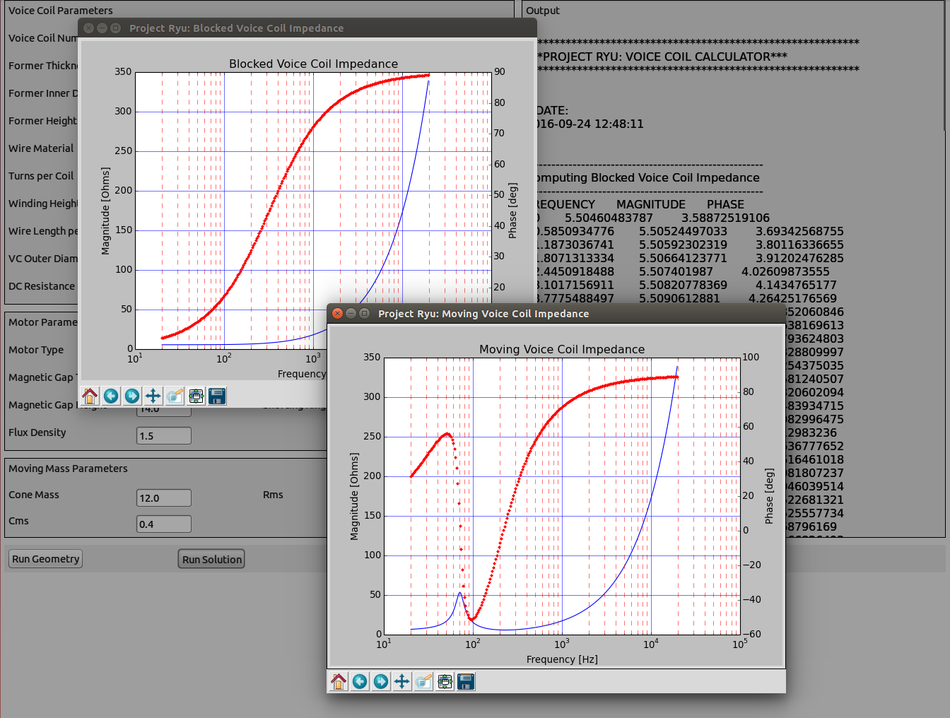

I am making a little piece of software to help design voice coils but not sure when I will finish it. I will do my best so that it doesnt take too long. You can see a pic of how it looks like. I will release it when it closer to finish.

what i will need are dimensions of the phaseplug, pot, top plate and voice coil. I will look for a cut-through image and mark dimensions i need. If you can measure those for me then we should be able to make a conversion.
