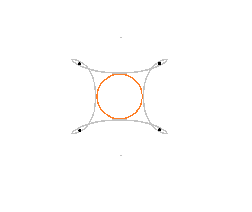

... based on this (i wanted to use bend guitar strings)
curved steel strings might be great
did you build the one in the picture ? ... or for inspiration ?

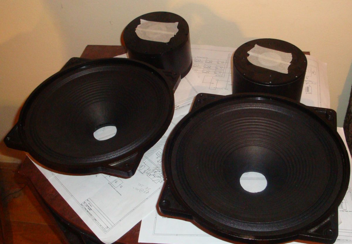

oh yes, just inspiration. picture is a creation of Be Yamamura from the 90s. Looks like the exactly set up pressure of circular steel strings from 3 sides could do the centering job well. if the excursion of the diaphragm is minimal, string may not be even attached to the coil former..
... string may not be even attached to the coil former..
but may better be

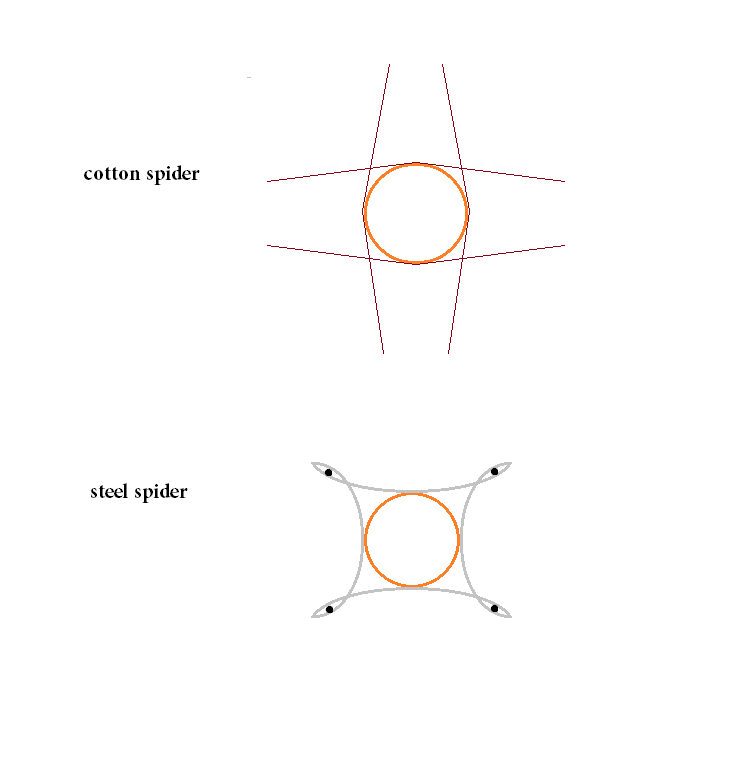

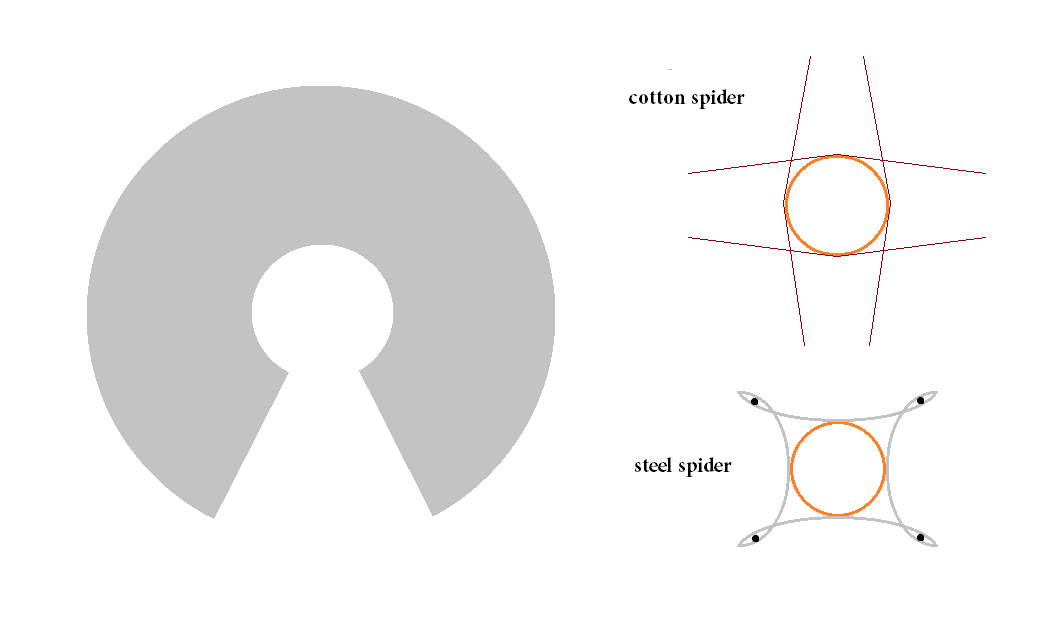

here is a quick drawing of the curved string idea
but may better be
i imagined a little notch in the coil former rather than a drop of glue but it surely can be attached intelligently.
ad visualisation - yes, something simple. (sharing a screw for 2 strings can make fine tuning harder, but that is just detail )

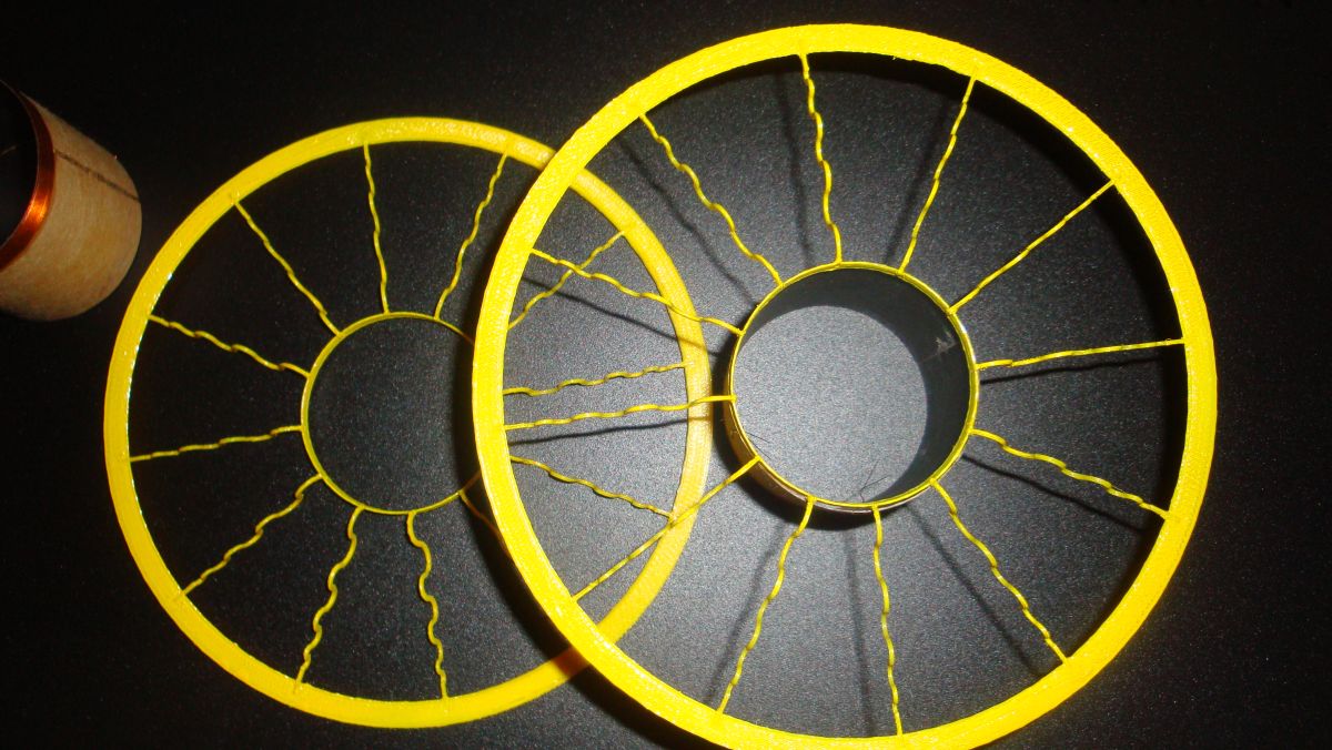

Like this:Perhaps an ideal solution is to use a helical double-start or triple-start machined spring as a spider replacement. They can be designed for low spring rate in the axial direction, which is nice for getting your desired Fs. At the same time, they can also have high spring rate in the radial direction, which is great for centering. Finally, they have no stiction which is a problem in slide-type assemblies (e.g. Adire Audio Parthenon).
