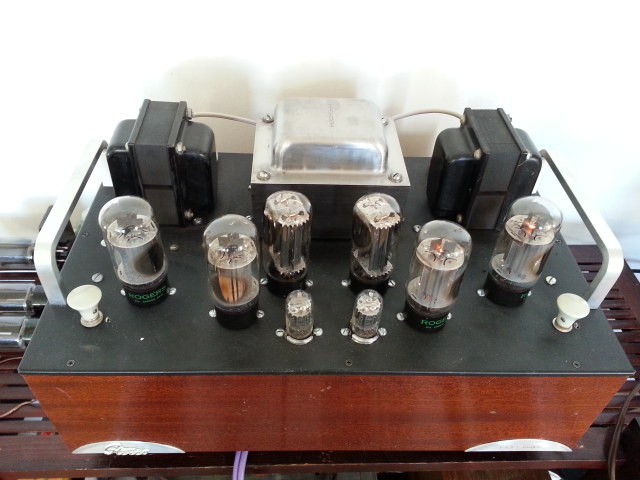

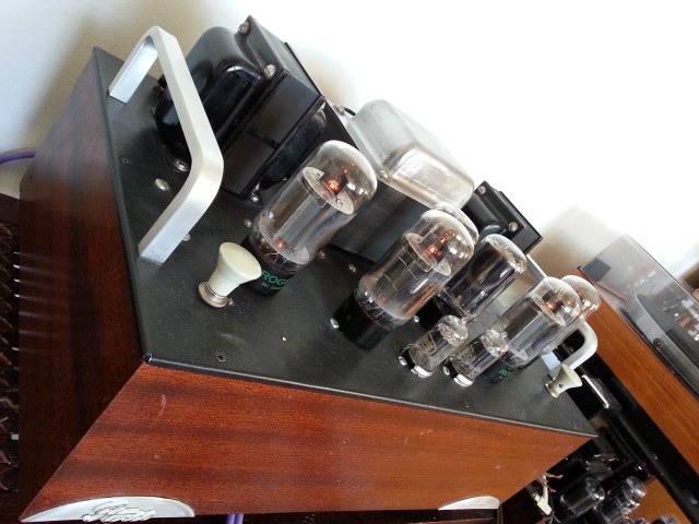

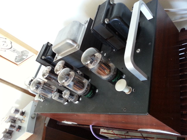

baldwin home brew stereo 6L6 stereo power amplifier all original parts
I BUILD A BALDWIN STEREO POWER AMP USING ORINAL PARTS AND CIRCUIT. BETTER THEN MOST AMPLIFIERS IN THE MARKET TODAY OR MEGA BRAND VINTAGE AMPLIFIERS.
SOUND REAL GOOD AND SMOOTH.
