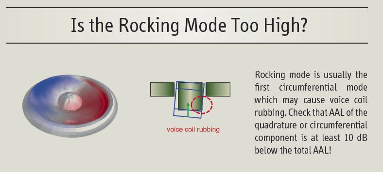

I think you may have driven the original drivers into a rocking mode by overdamping the voicecoils with direct drive (high damping factor) from the amplifier and active filters.
As I visualise it, the voicecoil doesn't have any freedom to move in and out, so cone energy escapes into a sideways mode. This can even produce voicecoil rubbing IMO. This happens less with traditional coils and resistive shunts. I could be wrong though.
