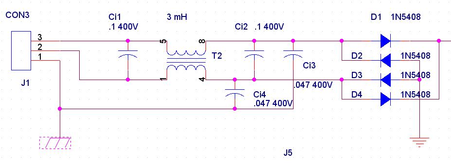

Thank you all, by looking into the common mode chokes I solved the problem quite well, I completed the input filtering circuit by adding a cap before and after the input choke and after this choke a cap beetween each of the mains line poles and chassis, this filtered quite efficiently and there are no more interference

For the moment and only for testing purposes, I'm using standard 400V rated polyesther caps, since I couldn't get the caps I wanted to test with...
Which are X and Y capacitors? What voltage rating should I use? I understand it's in the order of kVolts
here is the input filtering circuit along with the rectifier bridge

Ci1 and Ci2 must be X rated.
Ci3 and Ci4 must be Y rated.
The voltage must exceed your maximum mains voltage.
Here in the UK we use 275Vac because our maximum voltage is 254Vac.
250Vac X & Y rated are also available.
47nF to earth will allow a high earth leakage current.
It's more usual to use <=10nF to earth and many EMI filters use 2n2F
Ci1 can be fitted at the mains distribution board and can be upto 10uF
