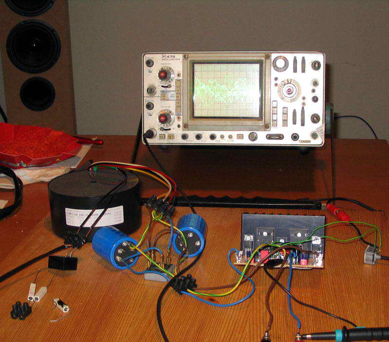

MikeB said:Fine !
But observe it, it might be undercompensated.
Okay, have fun listening !
Mike
I agree Mike, I would have played with the 10pF across C-B of that second long-tail-pair (man, I hate these schemas without component numbers. That's asking for trouble, as we have (again) seen. Why can't they take their own work serious?). Step it down from say 220pF until the situation is normal and than back up a few values to have a safety margin.
Jan Didden
Re: THANKS!!!!!!!!!!!!!!!!!!!!
Sigh... No real DIY spirit!. Try 100pF, if you still have the problems, try 220pF. Or forget this all and keep it as it is.
Jan Didden
Mlaen said:Ok, I hope this is finished!
I can't thank you enough for this!!
Milan, od kud si, ako se sretnemo imas cugu!!
PS
Janneman:
I don't want to do all that, ,what if I just put 220pF right away?
Jan Didden

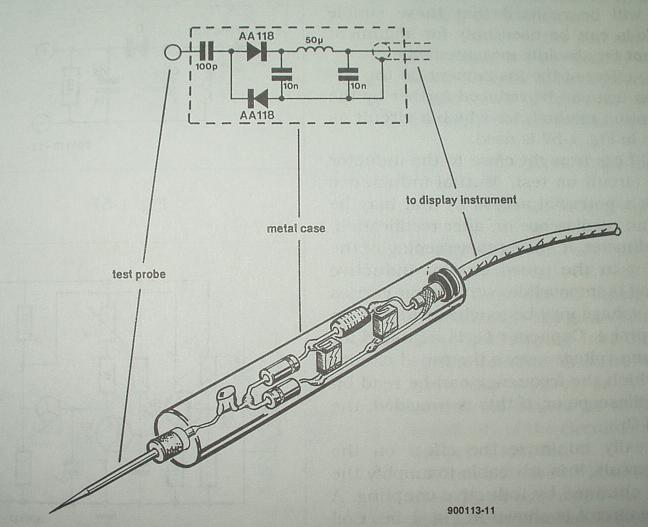

I think this could be the right time to suggest building a simple HF probe for detecting amplifier oscillation like the one in the pic below. All caps are ordinary ceramic ones (input capacitor could be around 1nF). The diodes are universal germanium or low current schottky (BAT85). Metal case could be taken from an old aluminum marker. By connecting this probe to DC input on DVM, it is possible to detect audio and HF signals much above DVM's operating frequency range.
(the picture is the courtesy of "Build Your Own Electronic Test Instruments" - Elektor Electronics)
Milan
