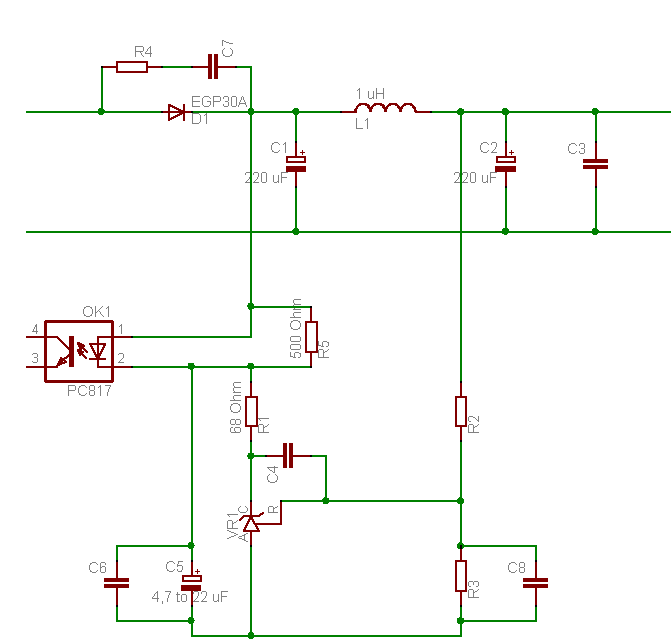

Hahaha.. yes it MUST work, what is your adress so I can send it to you... btw, I like challenges too so maybe I don't want to leave away my baby anyway! :D :D
Anyhow, attached is a principle schematic of the feedback circuitry, it's not fully accurate as for instance C4 and C8 have not bean used at the same time (though tested also together), but it shows a bit my ideas.
The idea is to let HF information go through C5 and C6 while TL431 takes care of the DC level.
Is this similar (maybe not in the same order as my circuitry but to the idea) to how you have designed your feedback?
Michael
EDIT: Forgot to connect feedback earth and voltage earth together in my quick schematic I put up!
C6, C5 and C8 are not required, connecting R2 after the inductor and the optocoupler before the inductor is just enough. Note that C4 makes the TL431 to work as a short-circuit at HF, thus ignoring the feedback from R2 and acting as if the optocoupler was connected to ground through R1 in series with a voltage source.
Simple, isn't it? This technique obviously introduces some kind of crossover frequency because feedback is being taken from two different points and mixed, and L1 should make effect well above that frequency. Also note that R1 is actually setting the high frequency open-loop gain of the circuit, and C4 together with R2 and R3 are setting a open-loop zero above which that gain is effective.
The TL431 actually works as a "DC servo" :) (speaking in audio terms).
Hi Eva,
thanks for your reply, yeah.. thats pretty much the basic setup I have worked with as you describe, so when it didn't solve the problem keeping DC level by load I added all these extra components.
In other aspects it has been stable except keeping the voltage level... :(
You say that C4 cap between A and Ref makes The TL431 work as an shortcircuit for HF, but here's the problem, it doesn't, it gives up and output impedance falls above 100 kHz while di/dt and dv/dt in SMPS circuits can have energy components easily upto the 100 MHz area.
The C4 cap doesn't help as CMRR is not enough, and further on can also be asymetrical depending if it's upgoing or downgoing signal, so that's why I did go even further to really let the HF energy bypass the TL431 by means of C5 and C6, at least this was the idea with these caps.
Well, tomorrow I will look into it further.
But once more the Tiny may skip pulses at ligth load as much as 9/10 pulses meaning the HF garbage decrease a lot and the so called rectifying phenomena decrease too, I think that with normal switching circuits that have a continous ongoing switching without advanced switch-skipping scheme like Tiny II doesn't show up this as clearly as the HF garbage is "constant".
Michael

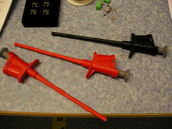

Hi Eva,
look at the picture and think what... :D
I have strugling with the powers*it so much that I was ready to trash that Tiny with a sledge until I "discovered" something! :eek:
Well, those probes as seen in the picture was in the drama and I had them connected at the other end of my 65 cm pair of tiny 0,2 mm2 wires until I measured directly at the output of the PCB I discovered that the voltage is absolutely stable by load, ok.. so i thought that it's the resistance in my wires, checkd the diamater and calculated the area to be, as mentioned, 2,0 mm2.
As my multimeters can't measure mOhm accurately I calculated the theretical resistance to be 0,1 Ohm all together, but thats only 0,2 V fall at 2 A, what the heck...:confused:
So I measured at the other end of my wires, not much of voltage fall, as well theoretically checked, and thought what is this...
I started to connect/disconnect all banana plugs around the probes but with no change, the voltage fall was INSIDE these probes! :bigeyes:
And actually at 2A load I could feel a very small warmth, not that someone usualy registrate. On these probes are markings ">6A", I had almost 1,5V fall over these at 2,5 A, i wonder how many watts they will develope of heat when 6A goes through them!
Well, the case is closed, my circuit works very well and regulate within around 100 mV from 0,1-2,5 A!
What a frustrating story, and a great release! :D:D
Cheers Michael
