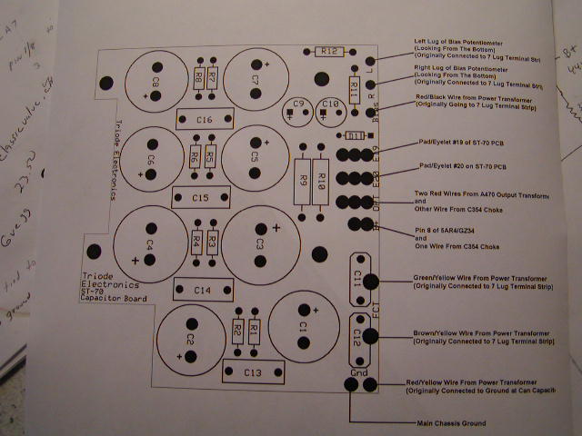

Is this the power supply board?
Did you ground the power supply board to the grounding point on the chassis? Did you ground the driver board to the same point?
OPT on power supply board to feed both red wires on output transformers.
Pad #20 on power supply board to #20 on driver board.
Pad #19 on power supply board to #19 on driver board.
As you are looking at the back of the bias pot ( shaft away from you) the left terminal goes to the R on the board.
"L" on the board goes to the right terminal when the shaft is away from you.

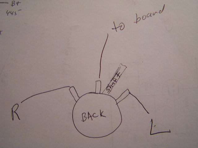

I may have screwed up here. Is this with the shaft way from me and the terminals down or up?
