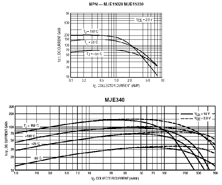

In yet another thread (http://www.diyaudio.com/forums/showthread.php?threadid=3539) someone claimed the MJE340/350 to have less current gain above 150mA and therefore not recommended as drivers (hence recommending the MJE15031/32 as replacements).

One thing I saw when comparing the two current vs. gain for MJE 340 and 15030.
For the 340 the gain graph goes from 1mA to 500mA and for 15030 it goes from 0.1A to 10A. I have set my amp to have about 35mA through Q8, idle current or whats it called. I have no idea how high this current will be when music is played.
But lets say it gets up to 50mA and the graph for the 15030 seems to fall when you look at it down at 0.1A. I looks like 15030 is happy when it has at least 0.2A and I dont think my design get up to that?
