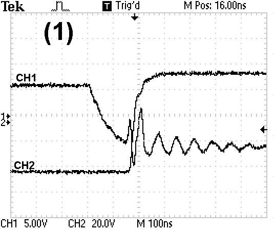

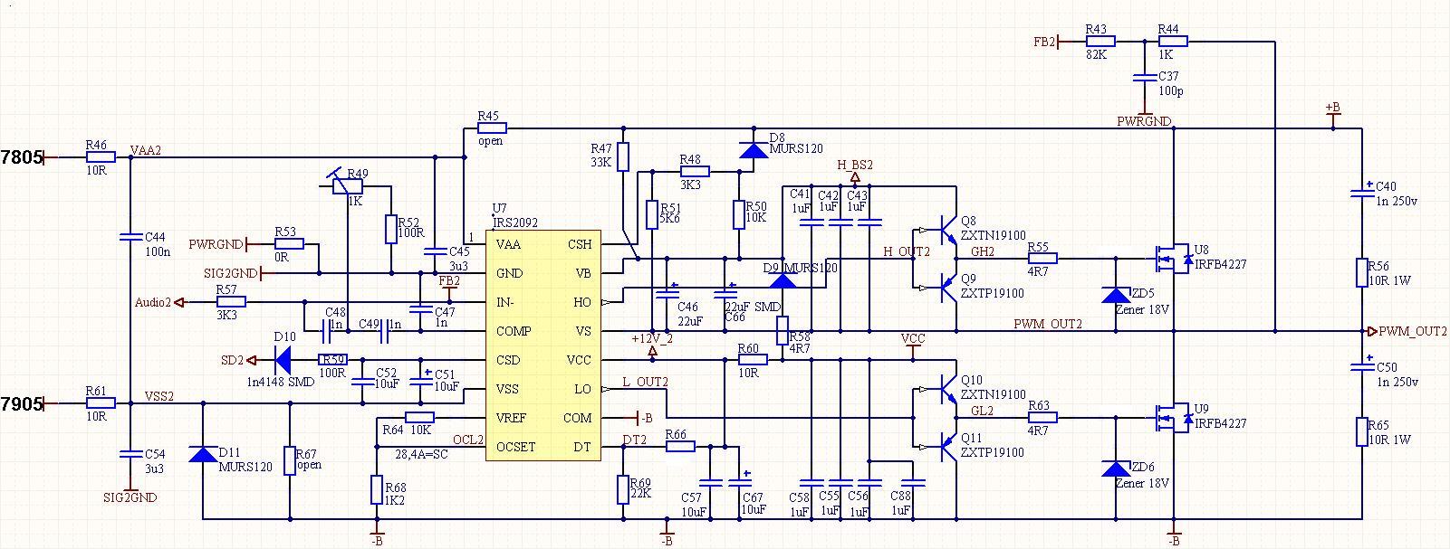

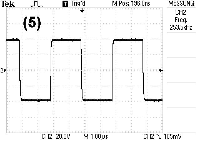

I'm working on a 300W Class-D amp with IRS2092 and IRFB4227.
Should deliver up to 300W stereo. The FETs where driven by a BJT totem pole and the amp sounds fairly good.
Theres just one problem: The MOSFETs getting hotter than they should in idle mode.
The Pics show more:

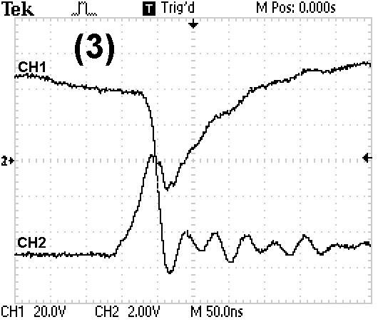

(1) CH1 Low Side Gate Signal CH2 Drain Low Side Rising Edge

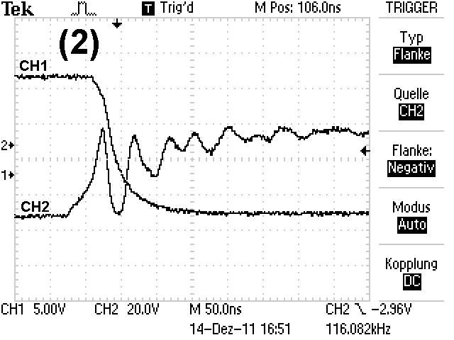

(2) CH1 Low Side Gate Signal CH2 Drain Low Side Falling Edge
(3) CH1 High Side Gate Signal CH2 Low Side Gate Signal Rising Edge

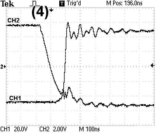

(4) CH1 High Side Gate CH2 Low Side Gate Falling Edge
(5) PWM Output Signal Idle (250kHz)
All referenced to -B
In (4) the High Side Gate have enought dead time but in (3) the it isn't enought and causes shoot through.
It seem's the DT isn't symmetrical on High and Low side of the IRS, I dont know what to do because already using max setting(105ns)
Supply is +-40V
thank you for help

I would make a different gatedrive circuit, you have some nice drivertransistors and then you add 4R7 in series with both turn on and off.
Why not try and make you gatedrive a little different, start maybe with a 1N4148 in parallel with 4R7 to make turn off faster than turn on?
A base resistor in you gatedrive transistors might also be worth it ;-)
Best regards
\\\Jens
The gate drive buffers need base resistors to control reverse behavior of the NPN/PNP when di/dt spikes show up at the gate (through Ld) and drive it temporarily outside the gate drive rails. Also, some resistive drive impedance is needed at high frequencies to damp potential layout resonances (MOS based gate driver outputs are resistive but always have capacitance and body diodes to the rails).
Speed up turn off with diodes and optional resistors as recommended, turn off di/dt must always be higher than turn-on di/dt to avoid "regenerative" cross-conduction during any overlap condition in switching. Don't make it faster than needed, gate drive "commands" EMI production. EDIT: IRFB4227 has 2.2 ohm of built in gate resistance, with a good layout it may not need more, just the diode.
(1) and (2) show cross-conduction further helped by the 20ns/50Mhz resonance. This resonance should be damped with RC(L) for optimum performance and minimum interference between channels. It's d-s capacitance of the MOSFET that is turned off (240pf typ. for IRFB4227) resonating with all the parasitic inductances that close the loop (TO-220 leads typ 12nH d-s, PCB tracks, supply capacitors typ 1nH per mm of lead spacing).
@Eva
OK i will add Base Resistors and Speed Up turn-off diodes, lets see if it improves switching timing.
Where i have to add the damping RC network because of the cross-conduction resonances?
Are the 1n 10R at the PWM Output bad dimensioned?

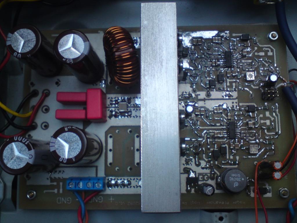

update:
I don't know why the MOSFETS got so hot but after adding the LPF there was no heating up.
The amp delivers 20W with 0,005% THD 200W with 0,065% THD and around 370W with 0,1% THD
Now I'm playing around with different output inductors. Like in many threads recommended the best results was achived with Amidon 106-2 core.

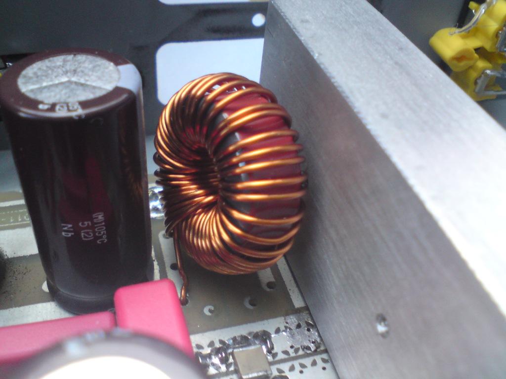

The only thing that bothers me is that the core needs 40 turns to get 22uH.
I'm using 18AWG (d=1mm) litz wire but in my view the DC resistance of the inductor is too high for my require output power isn't it?
To solve the problem i could use more litzes in paralell but one the core there isn't any space for more windings. What are your experiences with T106-2 or should i use a bigger one?
BTW: Power Supply is Connexelectronic SMPS800R +-60V now
I use the same core for a 750 watt peak amplifier.
I wind on 2 metres of 18swg but go around twice to get the required inductance. The core barely gets warm.

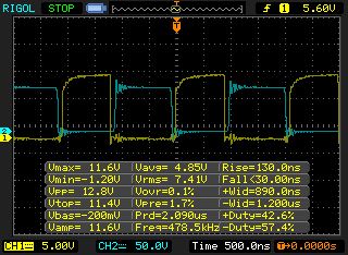

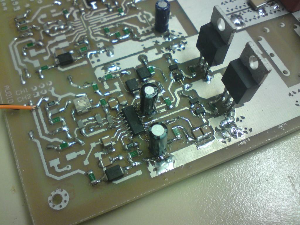

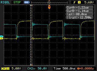

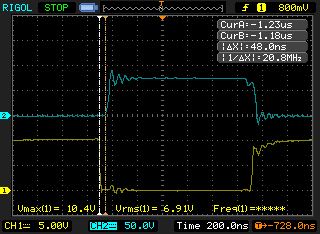

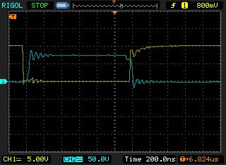

I had the same problem,the mosfets was heating so much in idle state,cross-conduction.
The falling time was too big. The way I solved this was adding and 1N4148 diode to speed the discharge,also I increased the DT to 80ns.
Fosc=450KHz
Mosfet = irfb4212
Supply=+-35vdc
DT= Firts attemps 45ns , succes with 80ns and diode.
I just add a diode in parallel to Hi gate resistor.
Ty , nice tips!
